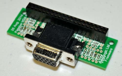

I can do this if I have a VGA666 adapter attached to the Pi via the GPIO, so I assume it should be possible with HyperPixel as well?
How do you accomplish this with the VGA666? From everything I’ve read, it’s still impossible to use a dual display configuration on the Pi since there’s no framebuffer, or GPU support for it. This applies to VGA666, HyperPixel, and the Official Touchscreen- all of which use GPU accelerated interfaces which become the primary display and steal the framebuffer away from HDMI.
I’ve certainly got the main desktop on HDMI with a video simultaneously playing on a screen connected via the VGA666 adapter. I’ll have to look again at what I did yo get that working.
