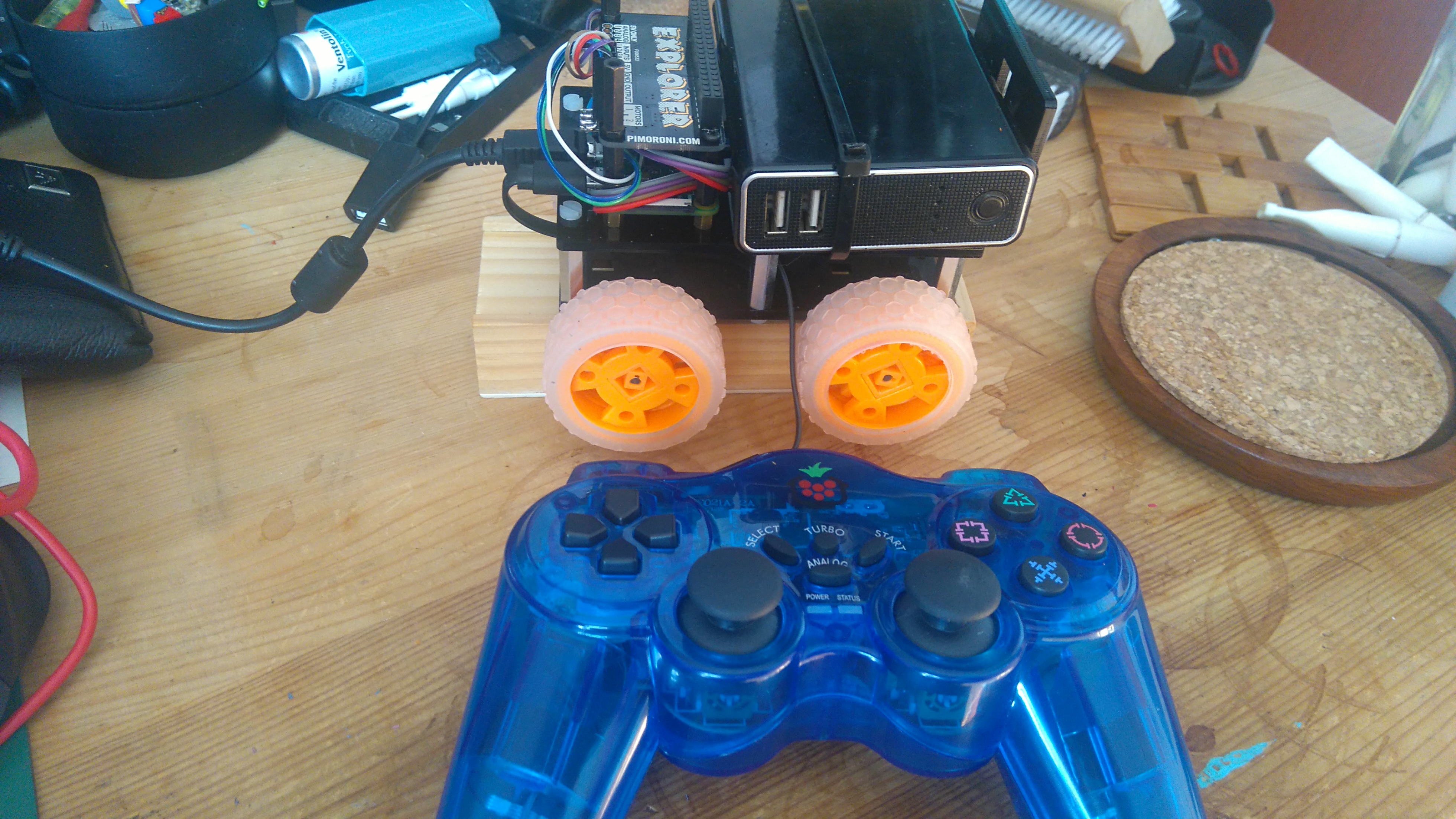

While the Pi is still connected to your keyboard and screen, you can test if the robot works. You need to plug the dongle that came with your Bluetooth gamepad into the Pi Zero W, and make sure the gamepad is switched on.
In the Terminal type:
python TinyPirate.py

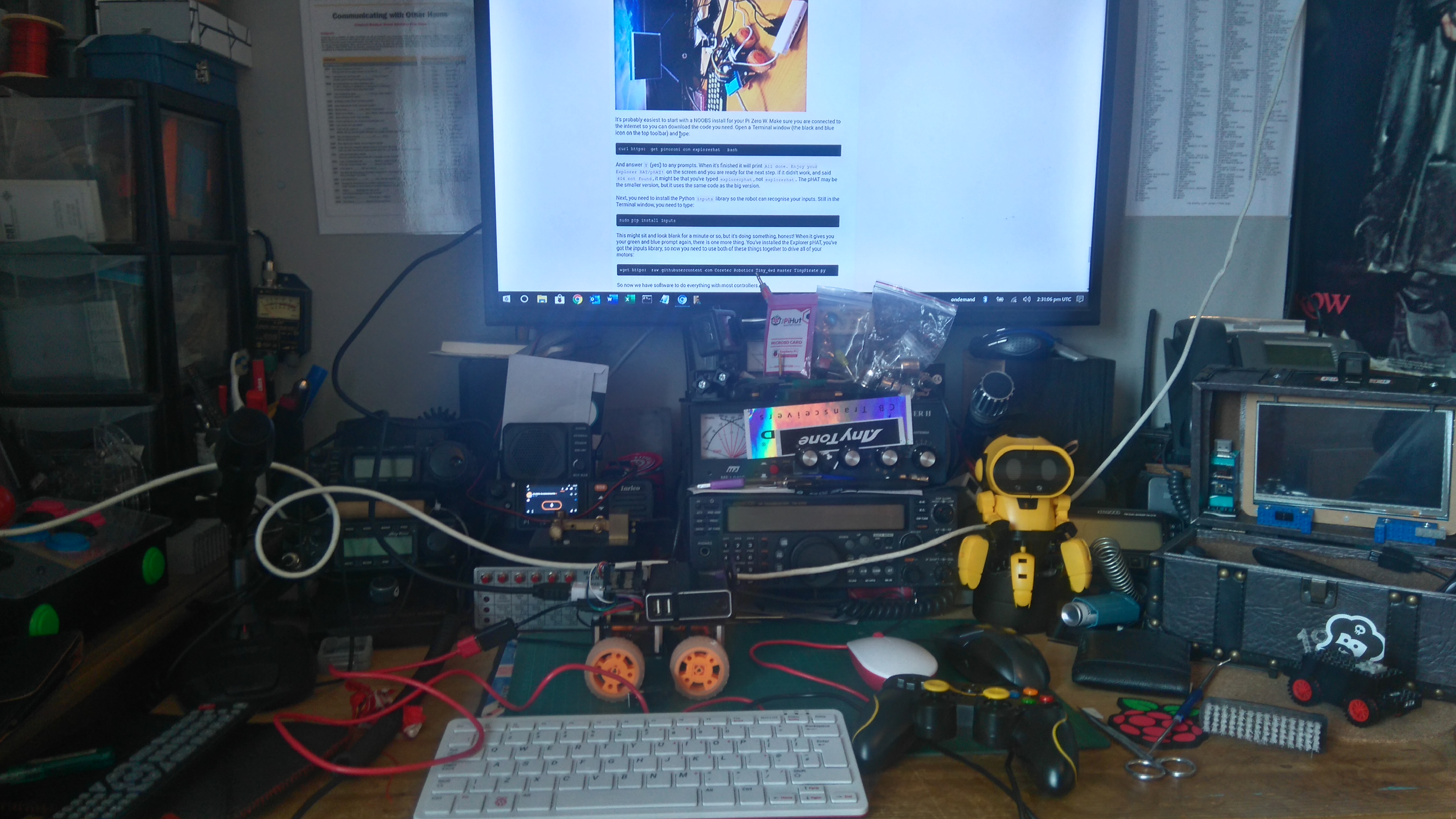

Now, hold the robot off the table and push the joystick forwards. When I did this, two wheels were turning forwards, and two were going backwards. Look at the coloured wires that join to the motors going the wrong way. My yellow and orange motor was going backwards, so I needed to swap the places of those two wires so they were the opposite way round. The easiest way to do this is in the breadboard. I also needed to swap my black and white wires, so the white plugged in where the black wire was, and the black wire plugged in where the white wire was.
Try making it go forwards again, and this time it should work. Once you have forwards nailed, you have backwards sorted too.

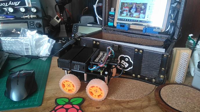

You have now saved the instructions. Now you just have to shutdown the Pi, unplug all the peripherals (except the controller dongle, that one’s important) and then you can run your robot from a power-bank if you want to drive it round without any wires.
Also, NOW is the time to stick the breadboard down to the car!
