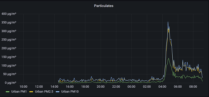

Mine are tracking pretty closely, but not exactly the same. I think that’s normal (it matches the Enviro+/Sensor.Community setup I have at the other side of the house at least)
