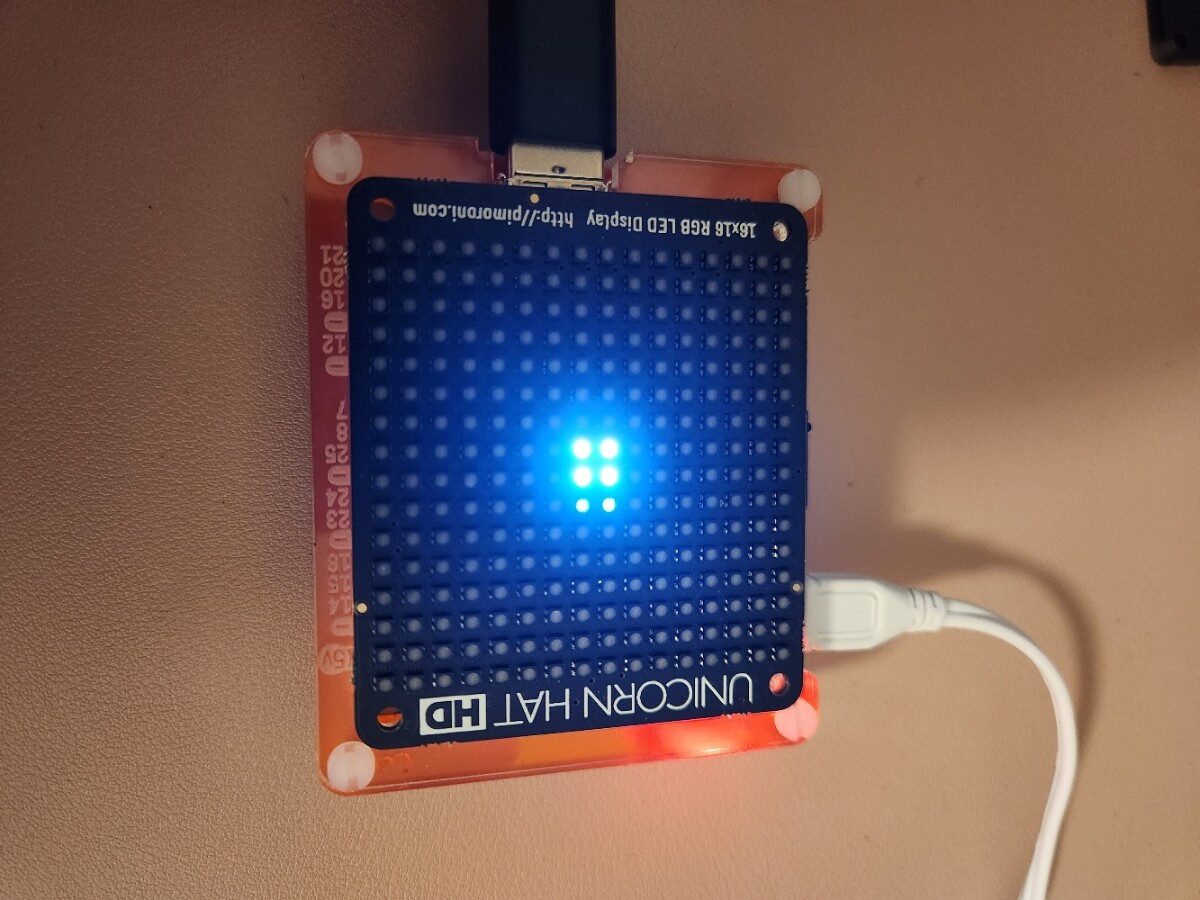

Hello everyone! I was hoping that someone could help me. I am creating a small test application to control a 2x2 dot of pixels with an xbox controller. However, there seems to be a an extra row of pixels that get activated every other frame so that they flicker green. Any idea what could be causing it?
Here you can see the extra row of pixels on.
And here is the code
