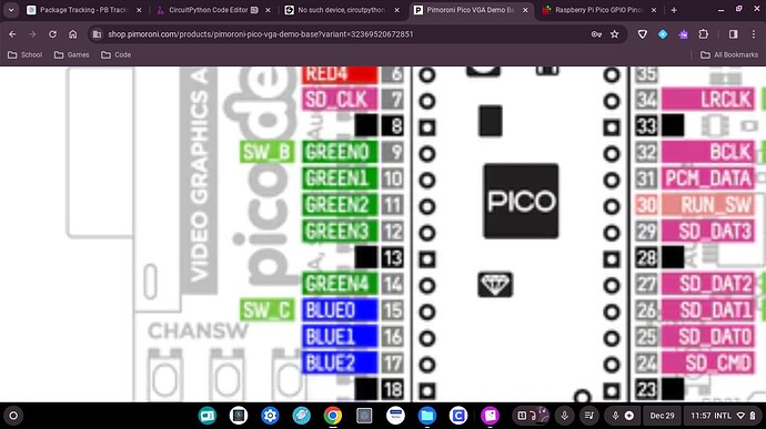

Pinout for VGA Base
They seem to be grounded
It looks like the VGA base uses the least significant bit of each of the colors with the switches.
what?
I dont understand man
I don’t have a VGA base to test but I would think that something like:
