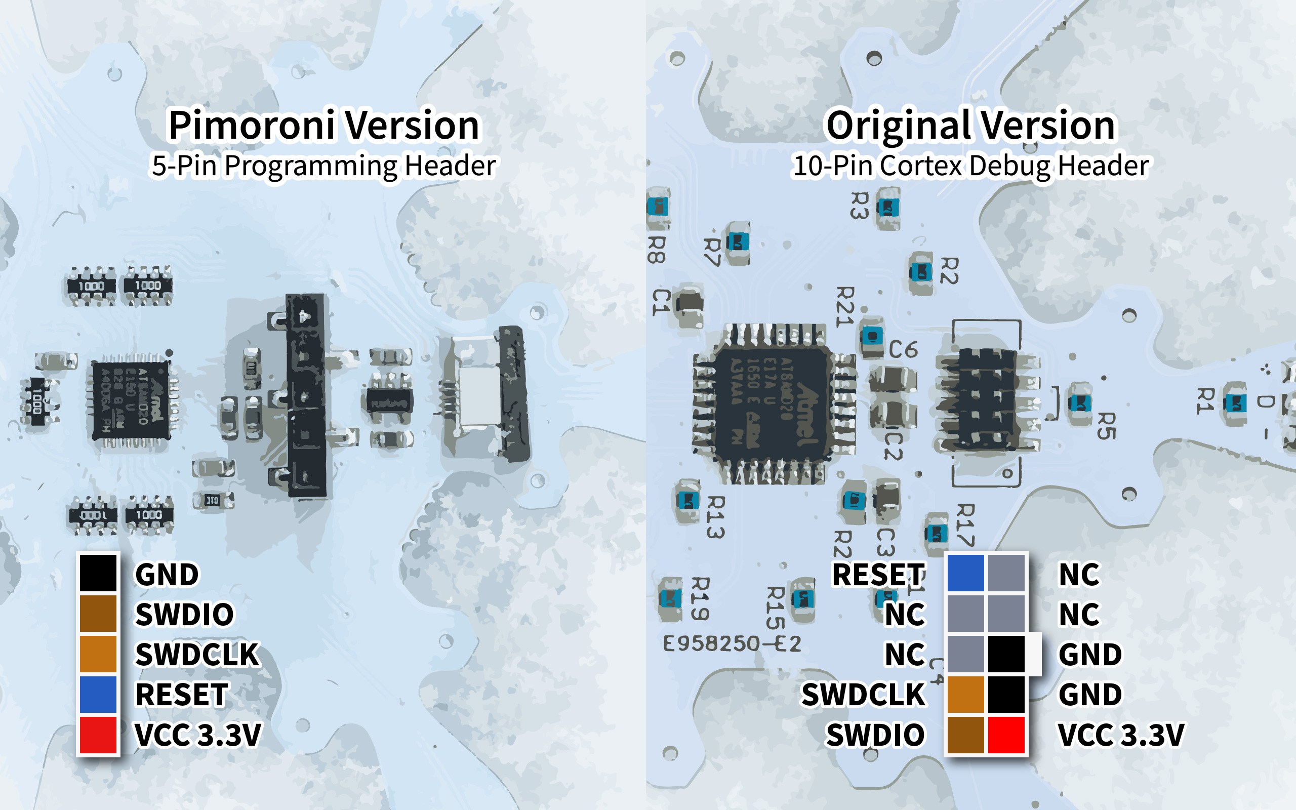

Well they have arrived and there are no programming headers :(
Does anyone know where to get these 5 pin headers to solder on?
I emailed Lucky Resistor and they have kindly updated the page: https://luckyresistor.me/2019/11/30/programming-the-snowflake-decoration/
I went for the bending pins of a normal header approach.
I used solder paste on a corner pin and used an iron on that while holding the header in place.
Then when that was done just soldered the other pins normally.
