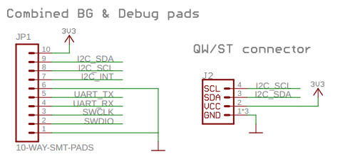

Has anyone used these?
Badger connectors
Is it safe to solder on wires and connect sensors or were they for test points during manufacture?

Yep, they’re intended to be used :)
The top five are our standard I2C Breakout Garden pinout so can be used for connections to breakouts/sensors that don’t have a Qw/ST connector (or for soldering on a Breakout Garden slot) and then at the bottom you’ve got broken out UART and SWD pins for debug programming.
