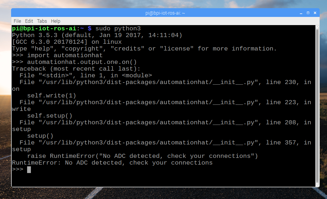

After that i opend the test program for python3 like the one for the outputs but I get
every time the error that there is no ADC detected. If want to manually toggle some output,
then I get the message that I don’t have permisson for /dev/mem.
I tried serveral things like to start the program in sudo but the I get the respones no ADC detected.

Thanks for the fast reply. I tried with sudo but I get the same error message
that no adc is connected. If I start phython3 with sudo and trie to set for exapmle
on output on high, I get the error message that I don’t have permisson for /dev/mem.
If want to give the user the permissions htan I get the message that I have the permission already and if I want to give the permission for memory space for the gpios than I get the message that there is no such dictonary or file.
