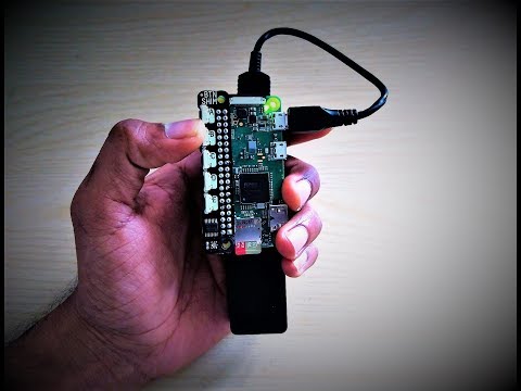

DIY Remote control for Google Cast Devices using Raspberry Pi Zero and Pimoroni Button SHIM
Click on the image below to see the demo
