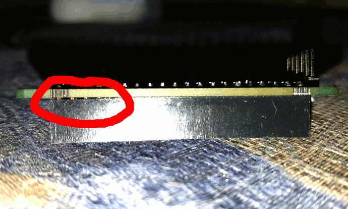

I have noticed that the soldering is not perfect, as shown in the picture.
It’s possible that imperfect soldering could be the problem, but unlikely. I suspect somethings gone wrong with the barometer. I’ve seen your support email, and will make sure it’s assigned to someone who can send you a replacement.
