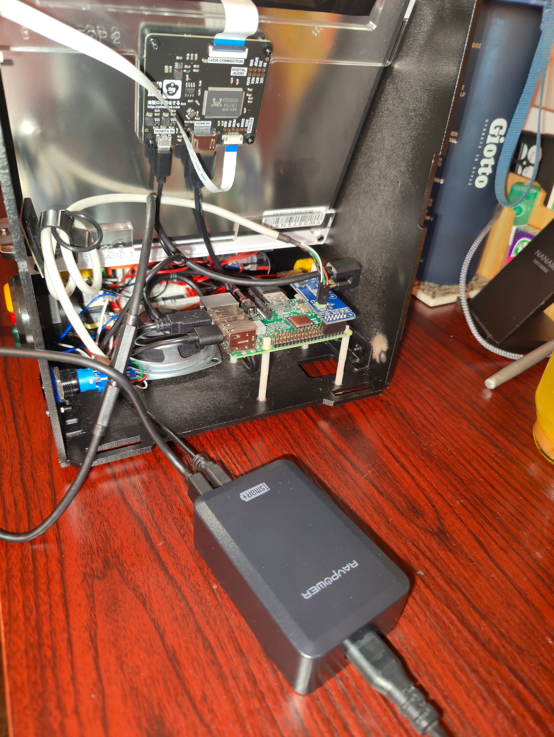

The reason I think it will work is my small 4 port usb charging station works fine. I just rather not use it since it’s a little bulky in the picade. See below.

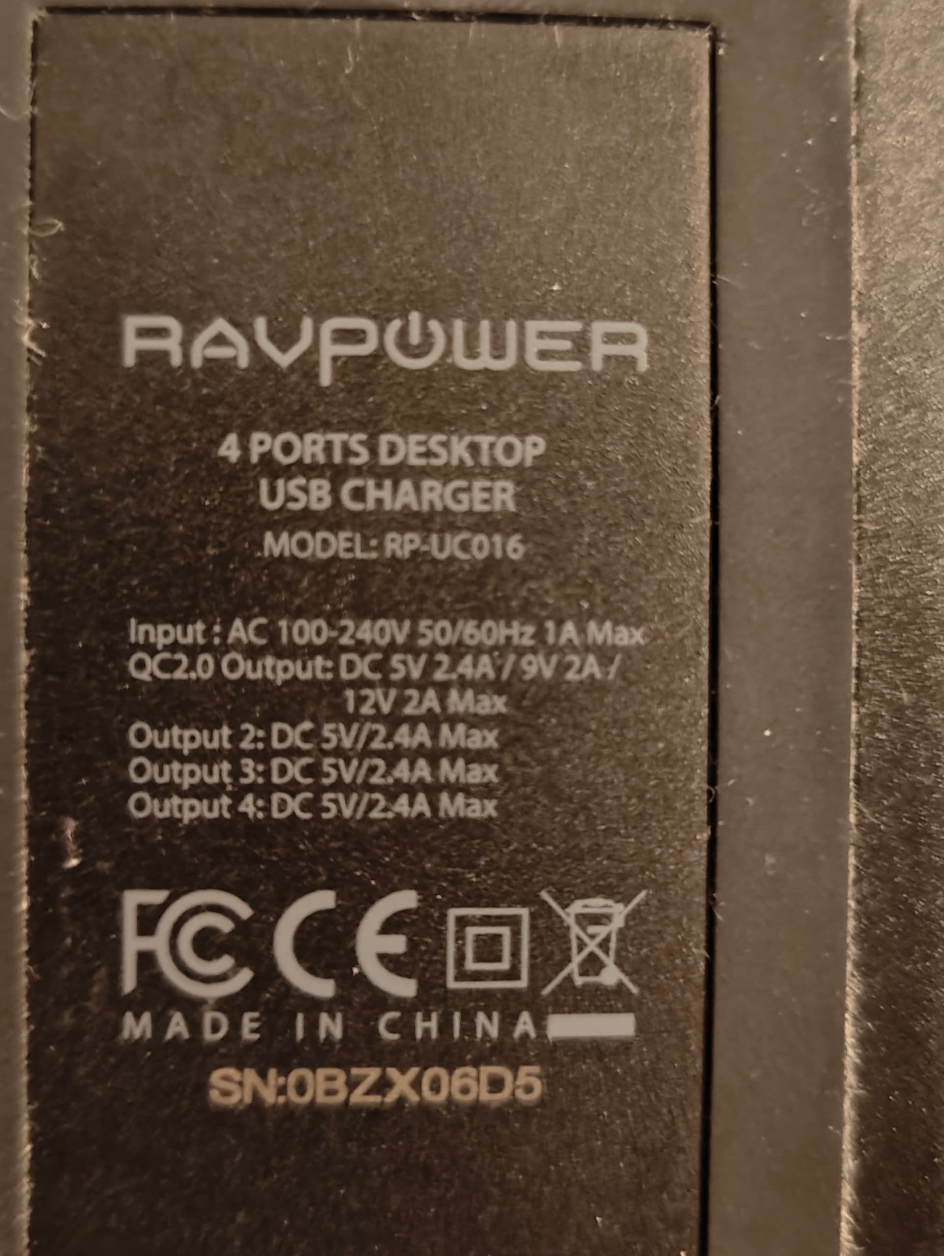

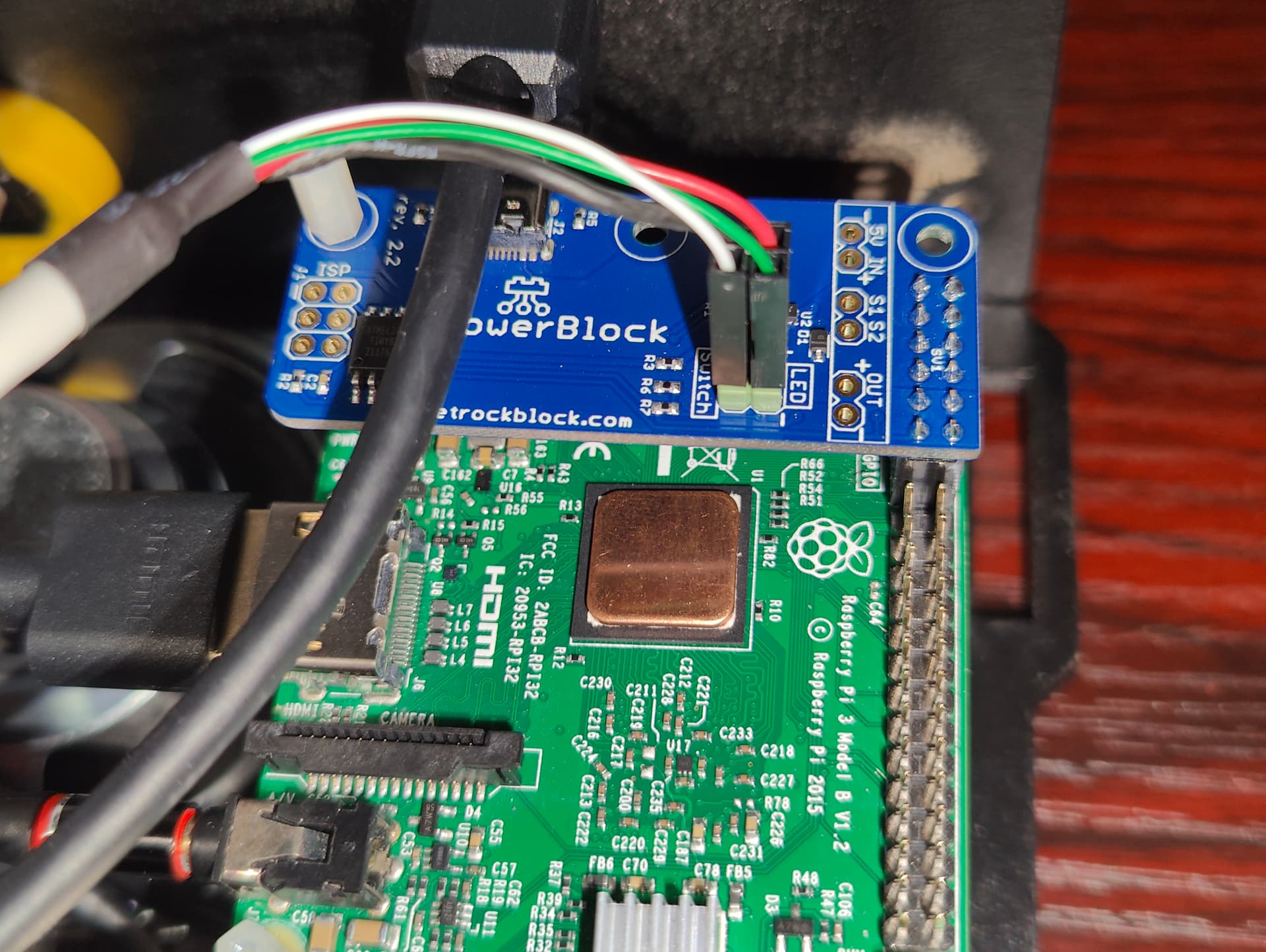

So I am using the Petrockblock power block to work with the power button on the side. So I have usb power from the usb charger and the audio amplifier. The only thing I have plugged into the usb’s on the pi is the 10 inch screen and the usb encoder. With this setup I get no under voltage. So I will try the same approach when I get that usb hub. Since it is externally powered I think it will work. I will just only use 2 ports…The audio amp and pi. Should work.

Well the Rav power I used is 5v/2.4a and it worked fine.

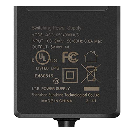

Good point. I also have this coming. It’s 20w 5v 4a…i would assume it will do.
Geekworm Raspberry Pi 4 Power Supply, 20W 5V 4A USB C Power Adapter Type C Fast Charger UL Listed Support Raspberry Pi 4 Model B/NASPi/DACPi/X-C1/X825/X735/X728/X708/X706/X703/X930 https://a.co/d/b0Ll5bC
Well this seemed to do the trick. No low voltage warning. I have the 1 plug from this 20watt 5v 4a power supply that goes to the power block. Then I have the USB encoder, 10 inch screen, and audio Amp plugged into the pi usbs. Worked great. No low voltage warning.

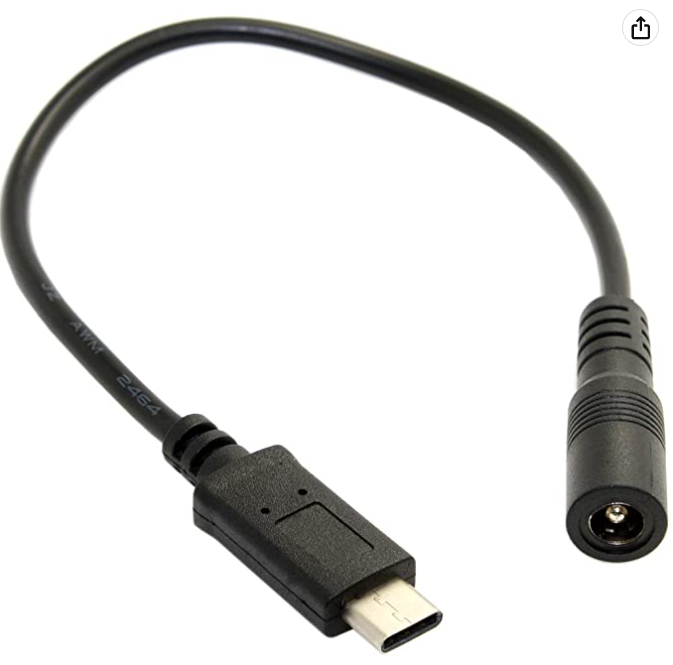

Would 30w 5v 6a be too much? I was thinking of maybe trying this.
with this adapter going into my Pi. This adapter is only for 5v so it’s perfect.

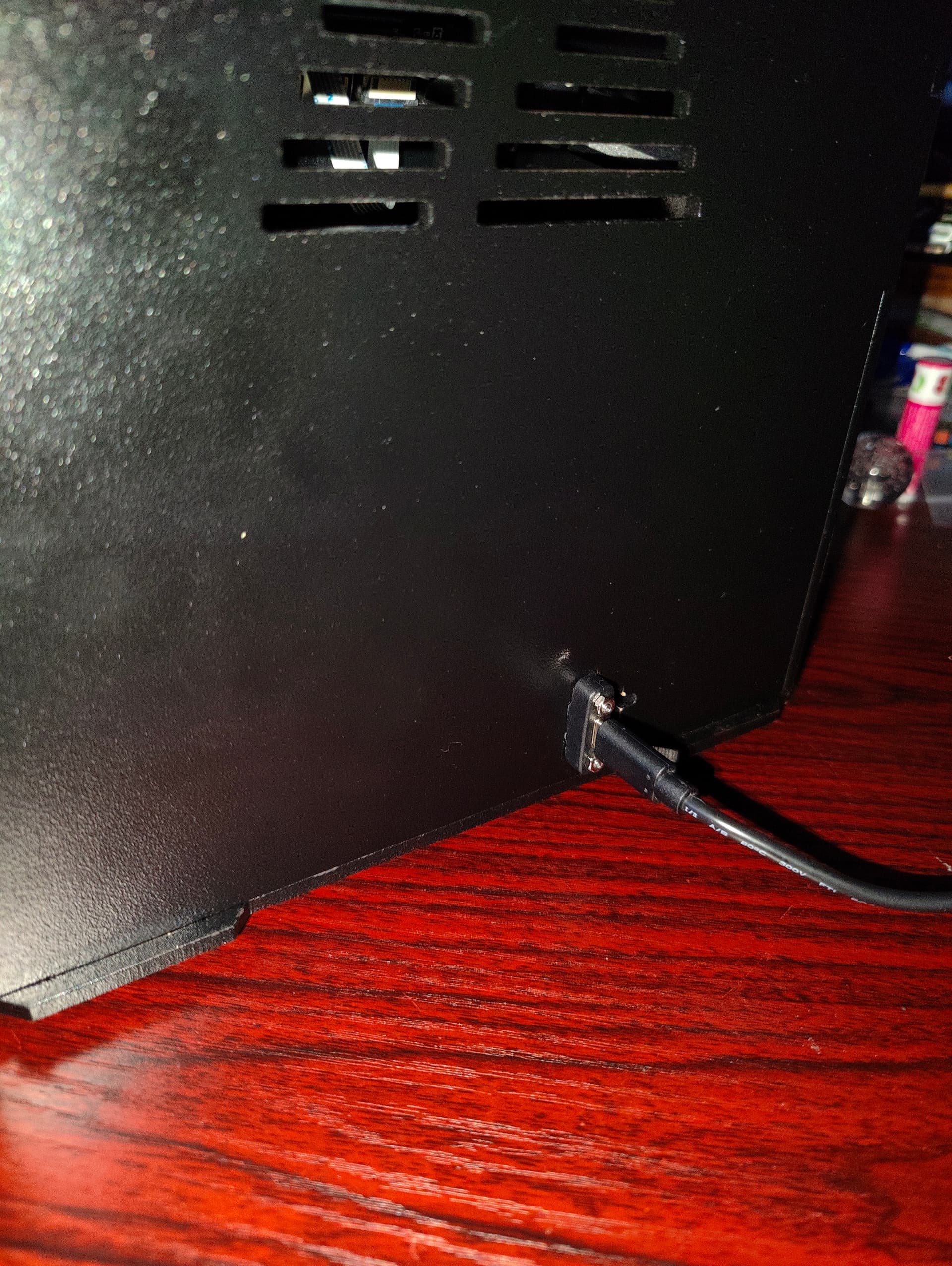

This is what is on the back of my picade to connect to my pi.
As long as it’s 5V and can supply enough current to drive what’s connected, all is good. Being able to supply more current than what is needed isn’t a problem. The load (Raspberry Pi etc) will only draw what current it needs.

OK that’s perfect. Currently my 20w5v4a solution is working fine but when I add the fanshim or crank the volume up it does low voltage. It’s OK for now I think long term I will go that 30w5v6a route. I can’t go higher because the petrockblock power block can only handle up to 7a. Thank you for your replies. I also hope it helps other that may read this.
