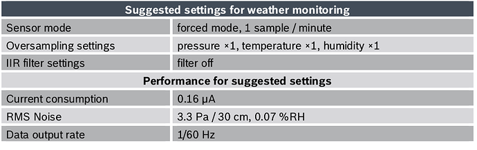

Can you check your program and see if it operates the BME280 in “normal mode” or “forced mode”? The latter is for environmental monitoring and the former for things like indoor navigation.
Also, you should not use any oversampling. pimoroni-pico/micropython/modules/breakout_bme280 at main · pimoroni/pimoroni-pico · GitHub
You should read the section 3.5.1 of the datasheet for how to operate the BME280. Too bad that the defaults of the Pimoroni drivers are far away from these recommendations.

Sorry for the wrong link, but the normal Python driver is not better.
You are using the defaults, and the defaults use 16x oversampling:
And in addition, you oversample again 4 times in a loop (at least you try to do that - but you don’t, since your counter is initialized within the loop and not outside). So this puts the sensor under real stress, you are effectively reading the sensor (4x) 3x16 times.
So the first thing to do is to manually call bme280.setup(...) directly after you created bme280 and feed in the correct mode (forced) and oversample settings. And reading the sensor once is all you need.
