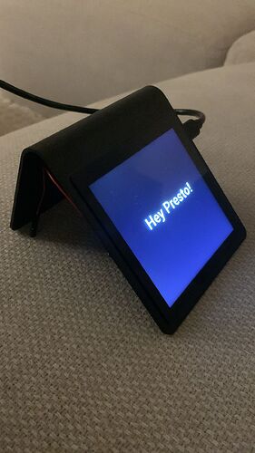

In fact, i want to try to use it like this /| instead of /_ so a 180 rotation and not a 90 like in my example (hope it is clear :d). I think it could be interesting on my desk!
Currently trying to configure it “manually”, but not impact for now…
