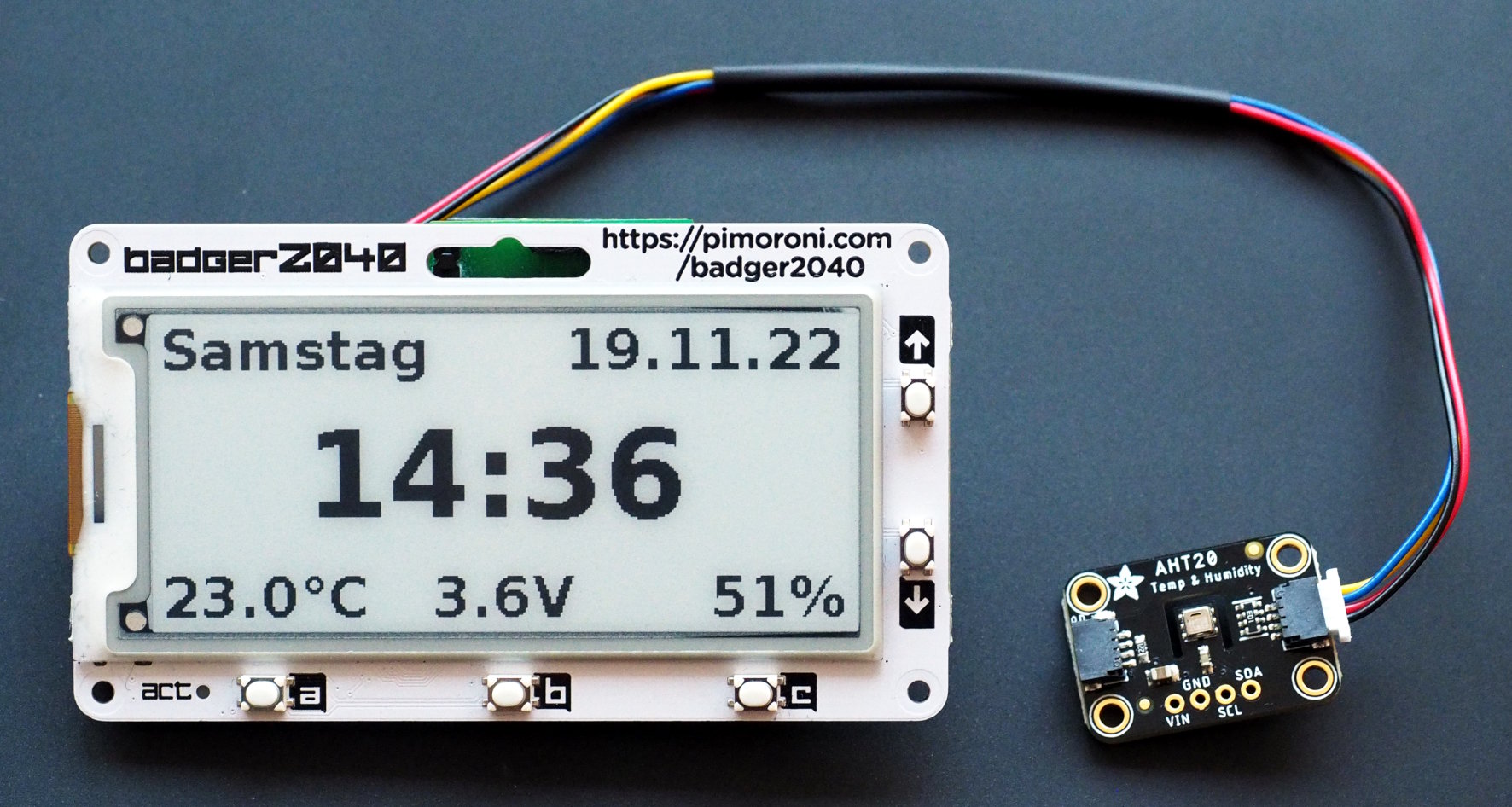

The color displays always need a full refresh of everything. Most B&W displays have partial refresh, which is much faster (but still slower than a normal display). I use a Pimoroni Badger2040W (which is B&W) for a clock. It updates fine once a minute:
Okay, thanks. So I guess there is no practical way I can use the color displays for a clock or something that needs to be refreshed under 15 minutes.
