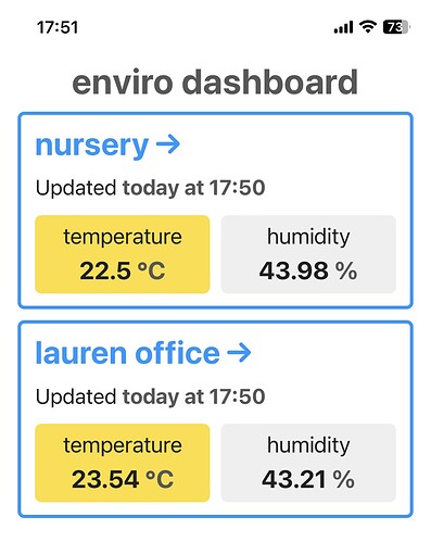

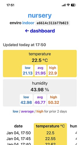

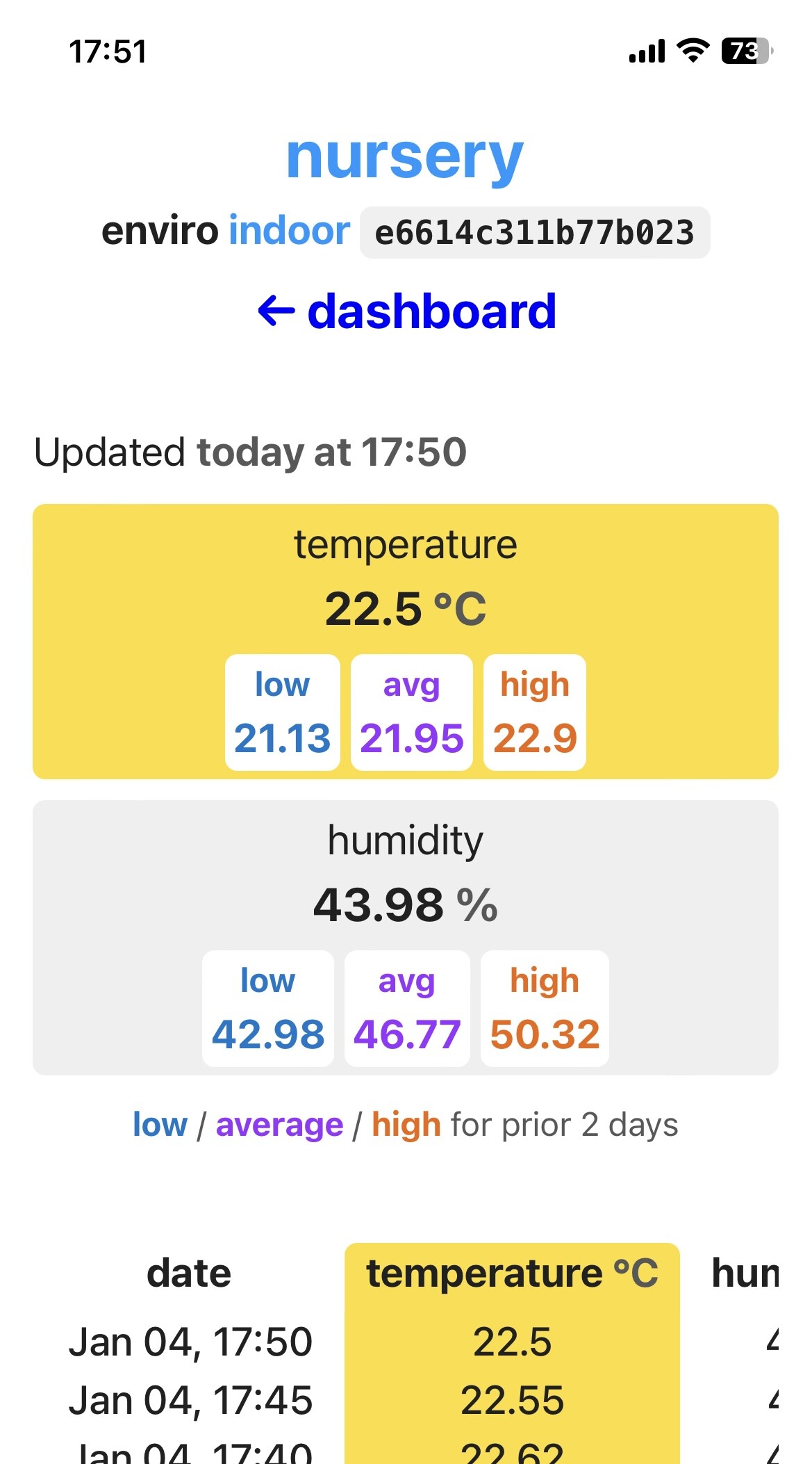

Hi there. I have a couple of the “pico w aboard” enviro indoor sensors, and the temperature readings are definitely too high (and too similar), presumably because the boards are connected to usb power and thus never go into deep sleep.
Has anyone had a go at compensating for that situation to get more realistic temperatures, or is that not really feasible?

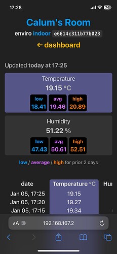

I think the proximity of an always-on pico generates too much of a false thermal floor for any numeric compensation to really solve the issue. I’ve switched to battery power instead of usb, which allows the enviro to go into deep sleep between readings, and the temperature values are much better.
