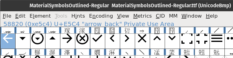

Have you checked (e.g. with fontforge) that the ttf contains the relevant code-point?
Yes, looks good to me.
Looking at the source code of afinate, it executes chr(58820).isprintable()
which returns False. So the output of your program is correct from the perspective of the program but I think for the purpose this check does not make sense.
