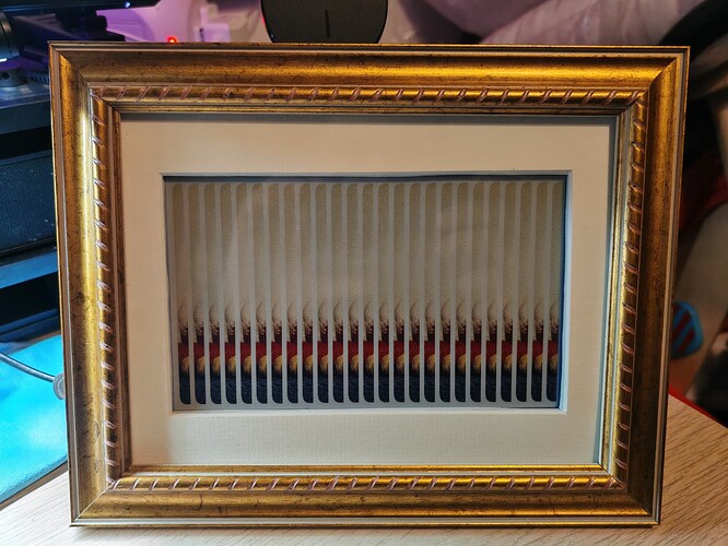

Hi all!
Been trying to get to grips with Python and the Inky Frame! I have an intermittent issue with display corruption like the attached photo. It happens every few days after running flawlessly and when it gets into this state, I need to do a full power reset to resolve the issue (if I nuke and flash the base firmware, with examples, the issue appears on the default main script too - I have to disconnect the USB & battery to resolve the issue).
I assume that my script itself isn’t directly buggy, but there is a memory issue somewhere.
Anyone got any ideas what I should be doing to try and diagnose the problem?
Not got the code handy to share - the script downloads an image from Dropbox, syncs with an iCal and gets the weather data online, updating the display 6 times a day.
Any help appreciated!
How exactly are you running your script? Does it use one of the InkyFrame sleep-methods? The reason I am asking: the InkyFrame sleep-methods actually don’t sleep, but turn off power - but only if you are running from batteries. So this is like a full reset. If instead you just use normal Python sleep or are running from USB, the program runs and runs and memory problems can indeed add up.
Thanks for the feedback! I’m calling inky_frame.sleep_for(), which I think is the right sleep method for Inky on battery power?
It had been a while since I checked, but I also get this when I try using an SD card (normally I use dropbox. The SD card was the one that came with the Inky frame and the error persists after flashing the nuke image to the pico).
SD card mount failed: timeout waiting for v2 card
WARNING: SD card mount failed but IMAGE_SOURCE is SD_CARD
Error reading SD card: [Errno 2] ENOENT
Was going to upload my source code, but the forums here only allow uploading graphics
inky_frame.sleep_for() is correct. But it only kicks in if you don’t connect USB. In your original post you talk about removing USB, so I am not sure if you are really running from battery.
You can post your code as text: just embed it in triple-backslashes (before and after the code). This way it is cleanly formatted.
I normally run off of battery power, the USB comment was just mentioned as part of my debugging process, but I appreciate that wasn’t clear! The entire script is over 3000 lines long, so might not make sense to paste it all(!). I’ll try to get a dropbox link later, but here is my main function for now:

My bad, I meant back-ticks not backslash for code-formatting.
Anyhow, this code looks ok. The inky_frame.sleep_for() will turn off the device. So if you see your problem once in a while it has nothing to do with the system running for too long.
So I would not blame the code. I could imagine two problems: power or a hardware problem. Before writing to support, you should check your battery level (VSYS). I am also using an InkyFrame and one information I always put on the screen is the current battery level to have an idea about when it is time to change/recharge the LiPo.
Interesting, I hadn’t been thinking about the battery pack. I’m using fresh Lithium rechargeable AAs. I believe Lithium batteries deliver a voltage similar to Alkaline Vs NiMH, which I think deliver 0.3V less typically.
I did a quick look at the docs for the Inky Frame and didn’t see how to get the VSYS value and what the thresholds should be (i.e. for good, bad, brownout levels etc)? Have you got sample code I could try?
There are many types of Lithium rechargeable AAs. Some deliver 1.5V, others nominal 3.7V and fully charged 4.2V. If you use a pair of the latter, you are far out of specs. Maybe you can link to your batteries? You can also check them with a digital volt meter. You will then have the no-load voltage, which is ok for detecting the type you are using.
From the software side, see Read system voltage on Pico W and estimate battery percentage · GitHub. This will give you roughly the voltage that the system is running with. Note that the percentage calculation in this gist is not valid, since there is no linear relationship between voltage and capacity. But i is fine for a first crude approximation.
Thanks, that helps! I assume that code would get the VSYS of the cable if plugged in? So I couldn’t use the prints in Thonny of the voltage for the test?

Although I suspect an issue with my setup than the hardware, given it’s new, I guess the battery supply wouldn’t account for the SD card issue? That happens even when the Pico is plugged in.
Yes, when you power from USB, your VSYS will be VBUS-0.1V (they are internally connected with a Schottky diode that reduces the voltage a bit). I read VSYS and put it on the screen, so I can also see battery voltages.

That is a valid point. The whole exercise is only to rule out some possible problems. If you can rule out the power-supply, then I recommend that you write to support and ask for a replacement, linking to this thread to show that you did a solid analysis.
The lithium batteries seem pretty reliable in my outdoor security cameras - I can normally get 6 months - 1 year from them. I don’t doubt that one might discharge into another, but if I’m getting a decent lifetime from them, it’s better than burning through throw away alkalines.
Based on the code shared, I modified my script to write the voltage levels each time the frame runs to a text file - this will stop me having to do spot checks. I’ve also written code to draw a battery low icon when VSYS drops below 3.5v - I’ve tested the icon will draw fine, but I’ve not seen it in normal operation (the frame has had around 3 refreshes since I wrote the code), so VSYS should still be reading >3.5V. I’ll collect data for a few more days and then figure out what to do next. The script will keep writing lines to the txt file, so I’ll need to disable the logging at some point!

The battery pack uses 3 AAs, so I guess I should get 4.5V from ‘fresh’ batteries. Thanks for all this detail though, learning lots!
The display corruption happened again. Got a log of vsys for a number of runs at-least:
2025-10-21 | 18:02:36 | 4.46V
2025-10-21 | 21:01:57 | 4.34V
2021-01-01 | 00:00:59 | 4.33V
2025-10-22 | 12:00:56 | 4.34V
2025-10-22 | 15:00:46 | 4.33V
2025-10-22 | 18:00:58 | 4.40V
2025-10-22 | 21:21:15 | 4.34V
2025-10-23 | 06:01:34 | 4.34V
2025-10-23 | 09:00:53 | 4.33V
2025-10-23 | 12:01:13 | 4.46V
2025-10-23 | 15:00:52 | 4.32V
As far as I can tell, those are relatively healthy voltages?
Absolutely! I don’t know what else to try, so I think it is the time to write to support and ask for a replacement.
