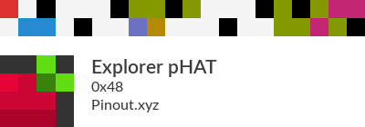

The pinout is here telling you what input goes where. That should tell you if the issue is with the Pi or the pHat.
