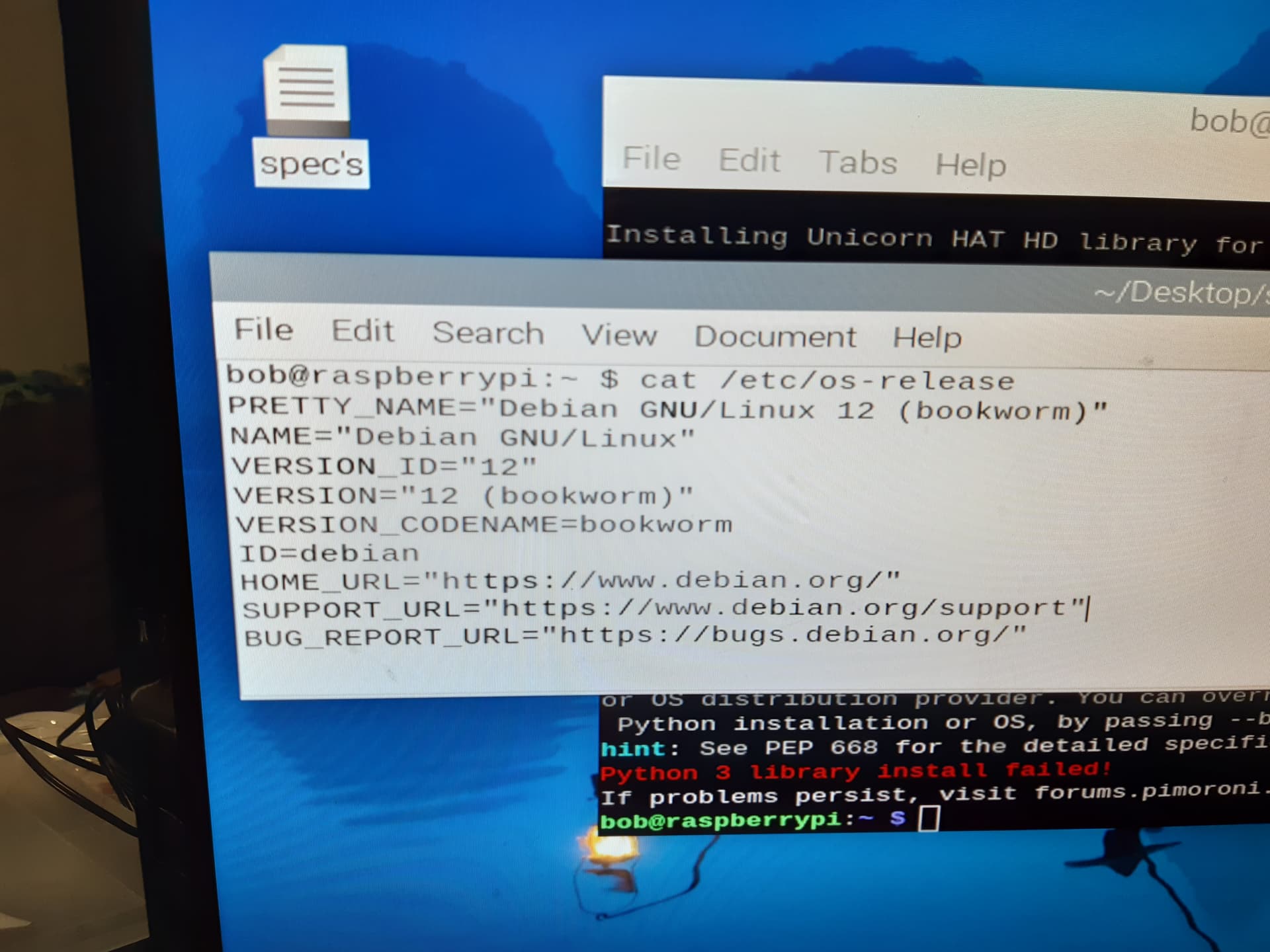

As far as I know I am using a debian package here are the specs
Bookworm uses a Python Virtual Environment. PITA if you ask me.

The operating system is linux 12 bookworm and the board is a 3b.

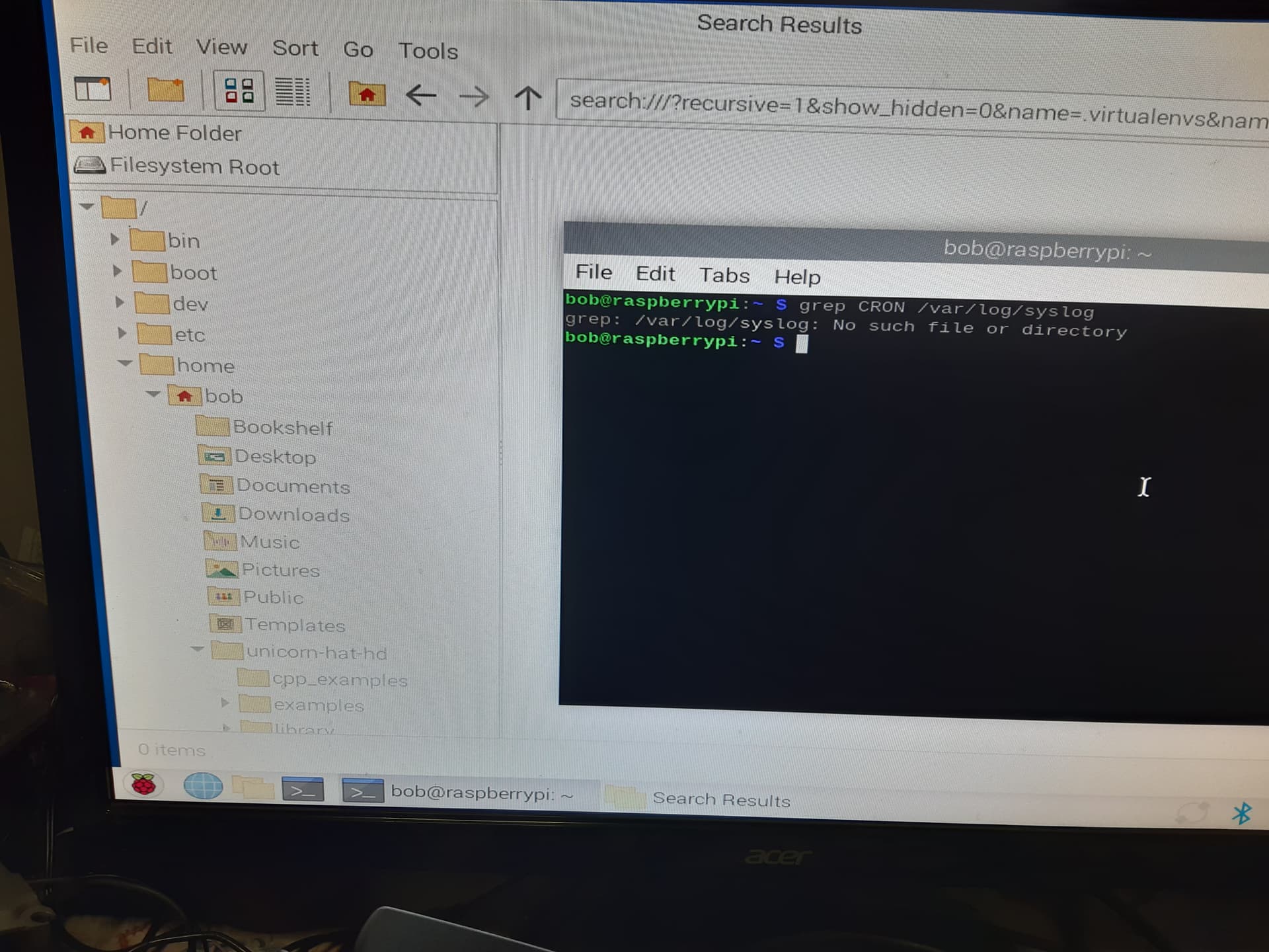

As I hope you can see from the screen shot
grep CRON /var/log/syslog
returns ‘no such file or directory’ ?
I named the directory I downloaded with the example files in as
unicorn-hat-hd as I hope you can see down the left side of the explorer box.
Is it possible I don’t have the directory .virtualenvs and that is part of my problem?
Do I need to be in a particular directory for the
to work?
I found a /var/log in the root directory but it doesn’t contain a file or a directory called syslog.

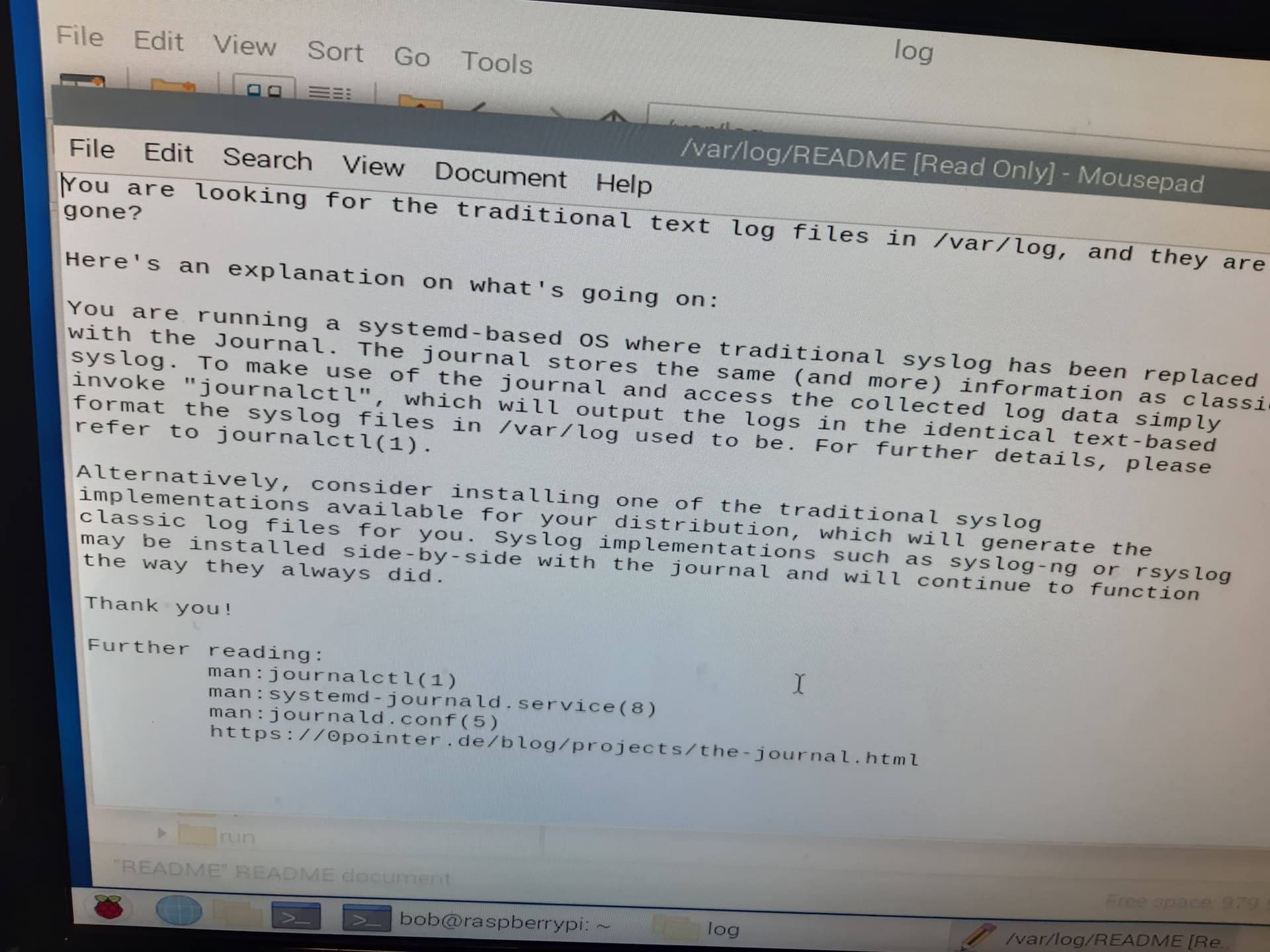

Then I found this readme in /var/log
Take a look at the last comments in this thread.

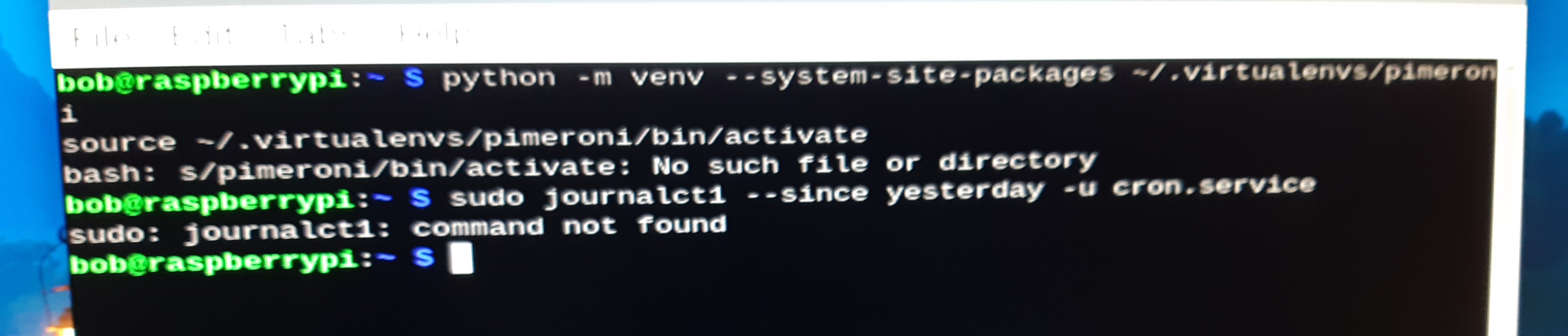

Looks like you need to use journalctl to access the system logs these days, try
 sudo journalctl --since yesterday -u cron.service

SO, I did the two lines to create a virtual environment and activate it but it failed to work
So I carried out your last instruction and that failed to work also.
