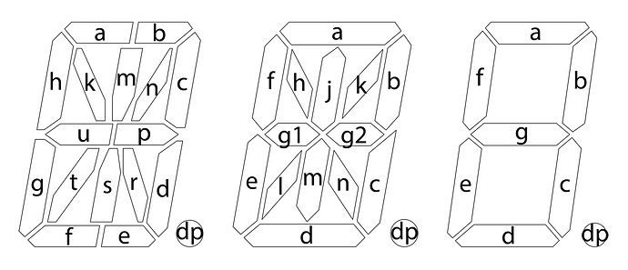

I managed to get the text turned around, these 14 segment displays make use of a character map which tells the display which led segments to turn on or off.
The character maps is defined in alphanum4.py, so in order for the text to be reversed one has to re do the whole map.
Here is my mapping,
Digit value to bitmask mapping:

One has to also now reverse the text, here is what i did,
           variable_temp_string = datetime.datetime.now().strftime('%H%M')
           # Show The Time
           fourletterphat.clear()
           fourletterphat.print_number_str(variable_temp_string)
           fourletterphat.print_str(variable_temp_string[3] + variable_temp_string[2] + variable_temp_string[1] + variable_temp_string[0])
