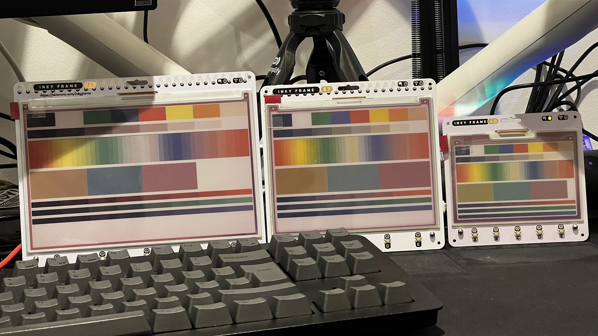

Does the display look the same as the 5.7" one? I don’t have the new 4" one.
From what I can tell the board itself is just scaled down.
As for the display it appears to have a better resolution, the “pixels” of the dithering look smaller.
Also, it might just be the different pictures, but I think the colors are a bit more vibrant/better contrast:
I agree on the colour it often looks more saturated with better contrast but I’m not exactly sure why. The dithering will appear better at same distance due to small pixels (higher ppi).

Some more images to compare in Instructables: Pimoroni Inky Frame Comparison - 4 Inch Vs 5.7 Inch.
