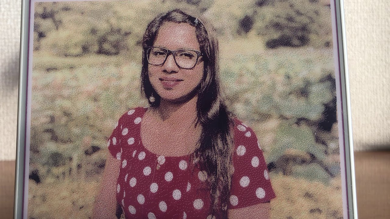

I have a Inky Impression (7 colour ePaper/eInk/EPD) screen working on a Raspberry Pi Zero 2 W
In the product page noted “It takes approximately 15 seconds to refresh the display.”
however mine takes about double(29secods.)
Do I miss bus speed settings or configuration for normal speed refresh?

Tested with older Raspberry Pi OS(Buster) with Raspberry Pi 4, I’ve got the same result.

Yes, the refresh on recent Inky Impressions takes around 30 seconds - this is because the controller in the newer displays has a built in ‘clear’ phase which cannot be skipped by sneaky software means. I think with earlier displays we had more manual control over the clear/refresh cycle, so were able to improve the refresh time.
Looks like this was updated on the page for the 4" variant but not on the 5.7" variant - sorry about that, I’ve changed it now. If the extra refresh time makes it unusable for your application, please drop a message to support (with a link to this thread) and we’ll do our best to help.
