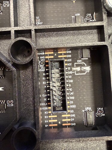

So further digging with the schematics means I need to build a breakout board for this panel to begin working .
Are there any markings on the back of the panel denoting which plug is Data In and Data Out?
Not that I’m aware of I’ve tried both sides , I’ve also done continuity checks and seen that both sides are linked together so I don’t think this panel minds
