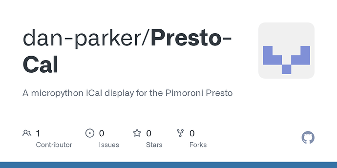

As part of a personal project for my Pimoroni Presto, I worked up a timezone with DST support library (as well as an ical parser)
While I’m not great with Micropython yet, spent considerable time making it memory efficient and as fast as I could make it. Hopefully it’s of use to some of you.
Included in the repo are some utility scripts to generate and help keep the binary blob data up to date for timezone changes in the future
