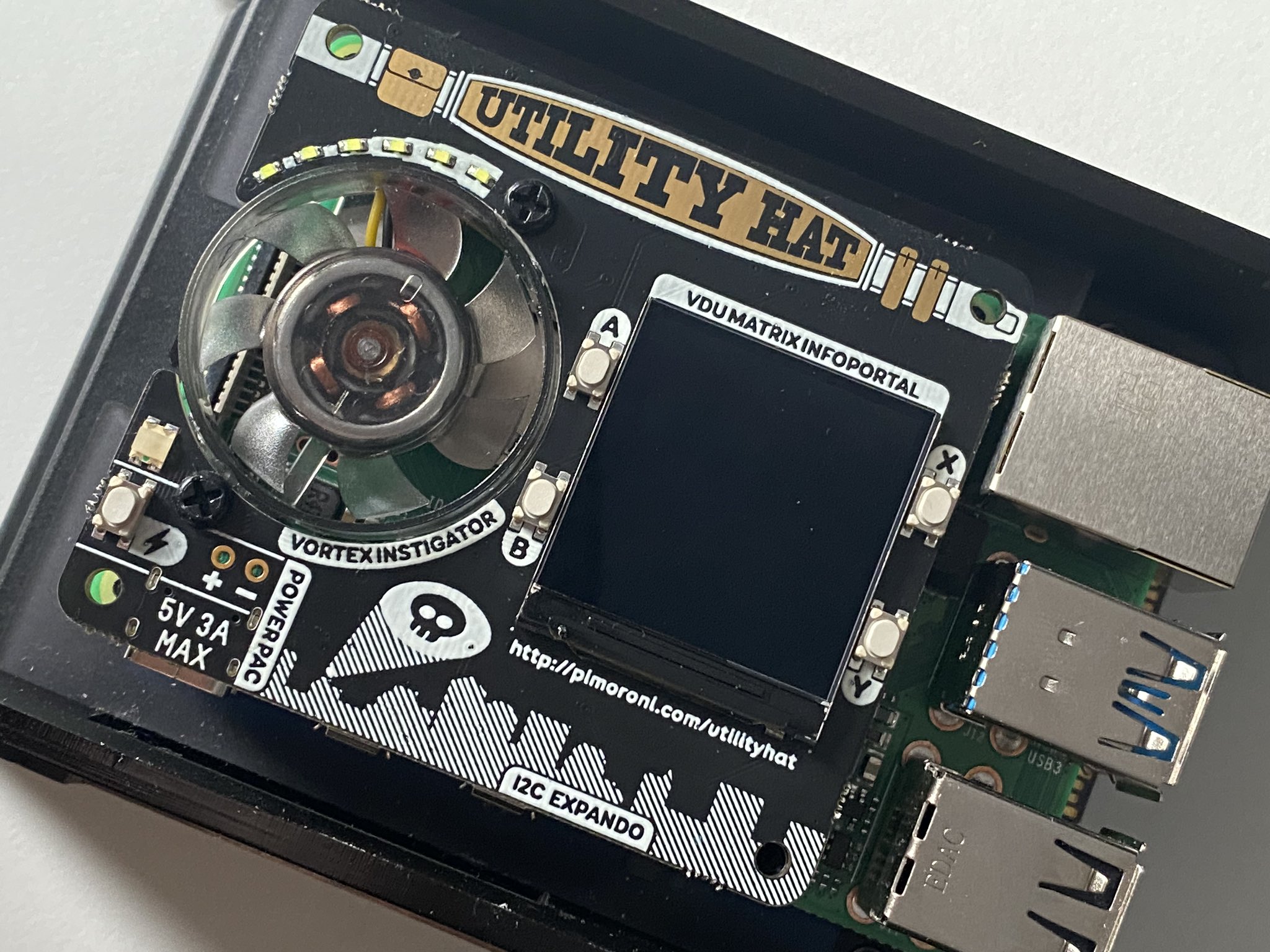

@JonF We have something along those lines in the works… It’s called Utility HAT, and it has USB-C power input (that back-powers the Pi 4) and on/off capability, a speed-controllable fan, 240x240 colour LCD, four buttons, and an RGB LED, as well as I2C expansion. Should be out in the next couple months, hopefully.
