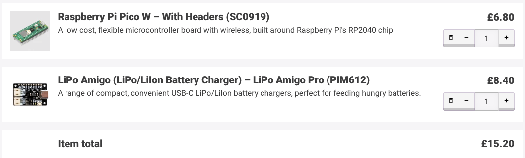

This is absolute overkill. For the sensor, you need two pins, not 40.
Why not just use a Pico-W (or Pico2-W) together with a LiPo-Amigo-Pro? The Pico-W still has 26 pins, so that is plenty even if you want to attach more peripherals.
Pico W + LiPo-Amigo-Pro = is 15 GBP
Vs Pimoroni Pico LiPo 2 XL W at 21GBP. Save myself 5GBP I suppose and get headers.
It is not only about the money. The Amigo Pro is much more flexible. You can attach wires and thus route all functions to a panel when the system is inside a box.
