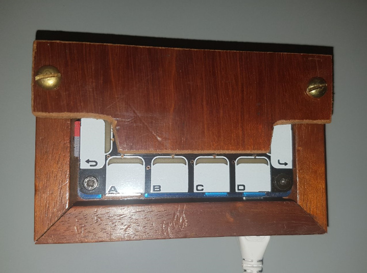

So I’m loving the TouchPhat and have attached to my fridge. I have one button to switch my amp on and off, two buttons for volume, leaving me with three buttons for Kodi (B is currently PartyMode music, C and D are both Radio stations). But I wonder is there a way so that a button cycles through Radio stations? eg first press Radio 1, second press Radio 4 etc. I’m very new to Python and would appreciate any ideas. Currently it looks like this…
@touchphat.on_release([‘C’])
def handle_touch(event):
print(“Radio 1”)
my_kodi.Player.Open({“item”:{“channelid”:21}})
@touchphat.on_release([‘D’])
print(“Radio 4”)
my_kodi.Player.Open({“item”:{“channelid”:20}})
