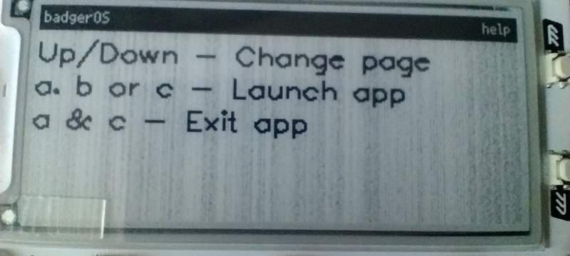

When I’m on the menu, the display always stays like this:

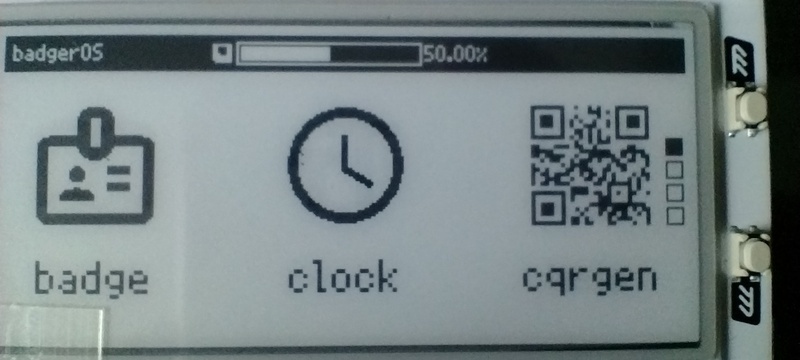

However, when I’m in an “app”, the display initially is clear, but after a few secs develops these vertical stripes:
This seems to be dependent on the method of powering the badger.
- I’m powering the badger with the recommended lipo battery (Galleon 400mAh Hard Case LiPo Battery), which gives the stripes.
- When I power from USB, this doesn’t happen.
- When I power using a 2*AAA batter pack, this doesn’t happen.
Edit: I fully charged the lipo now, and the stipes do not appear. So I guess it might be to do with low power on the lipo?
