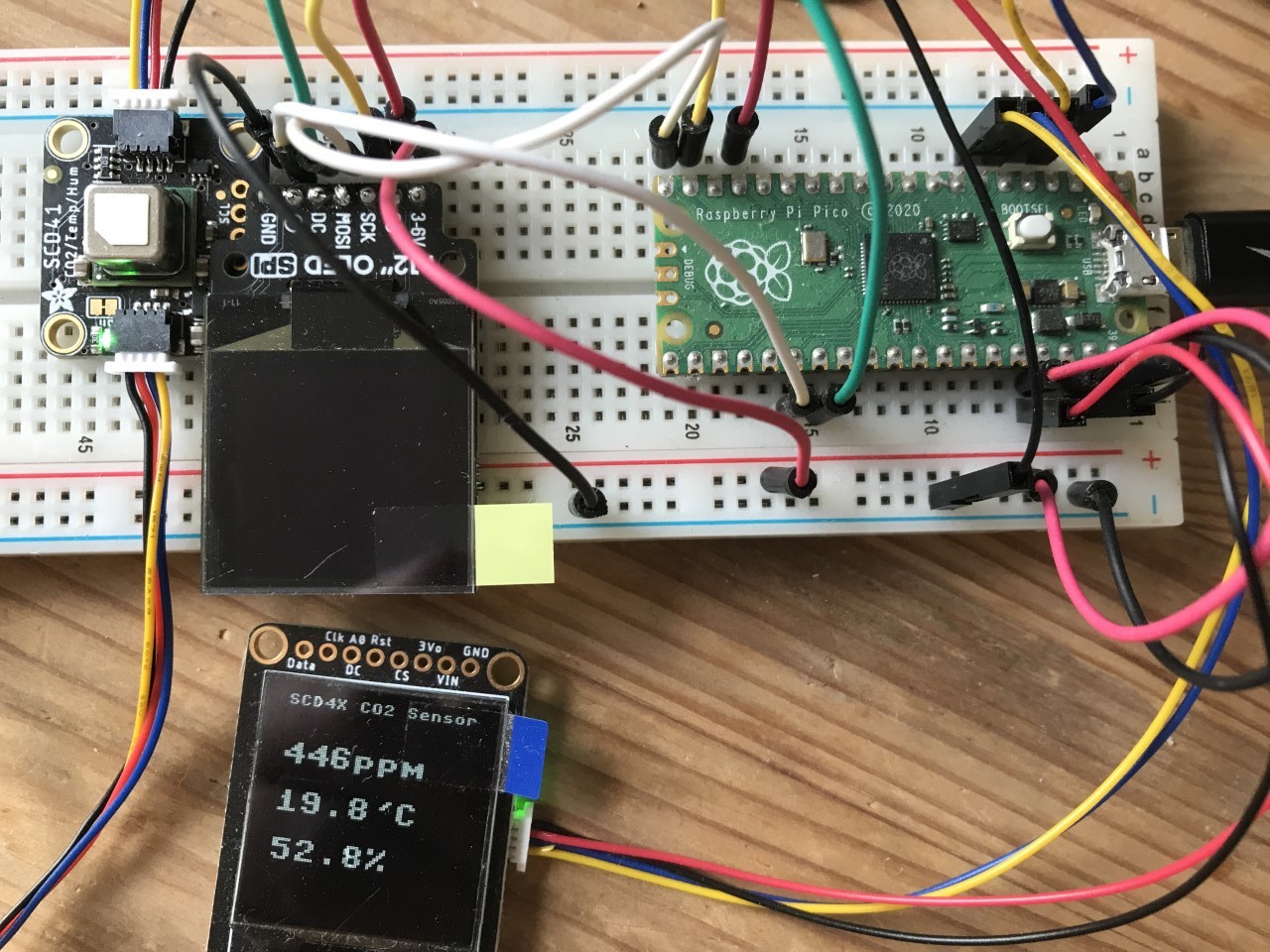

Are you still looking for a MicroPython driver for this display? I have written on which you can find on GitHub. There’s also a MicroPython framebuffer extension on my GitHub page that allows you to display text in larger font sizes on the display.
There’s a picture of it in action below (with a SCD41 CO2 sensor). It can also drive the Pimoroni 1.12inch SH1107 OLED shown in the picture - not switched on in this picture.
Let me know if any problems.
This works perfectly - Many thanks.
SOLVED!
