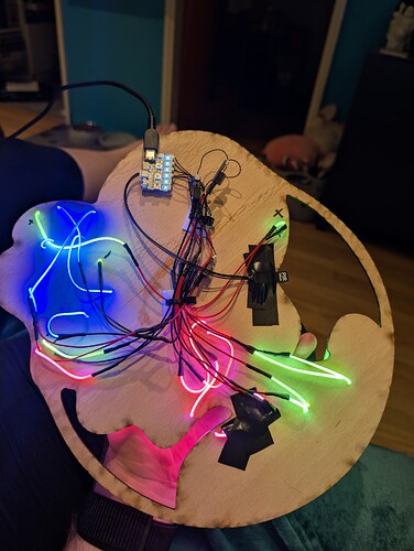

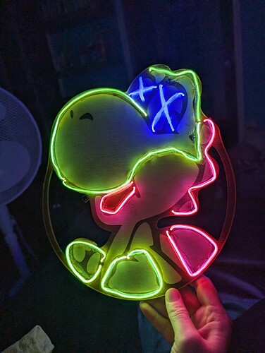

Made a Yoshi “neon” sign with adafruits noodles and a tiny fx controller activated with the PIR sensor.

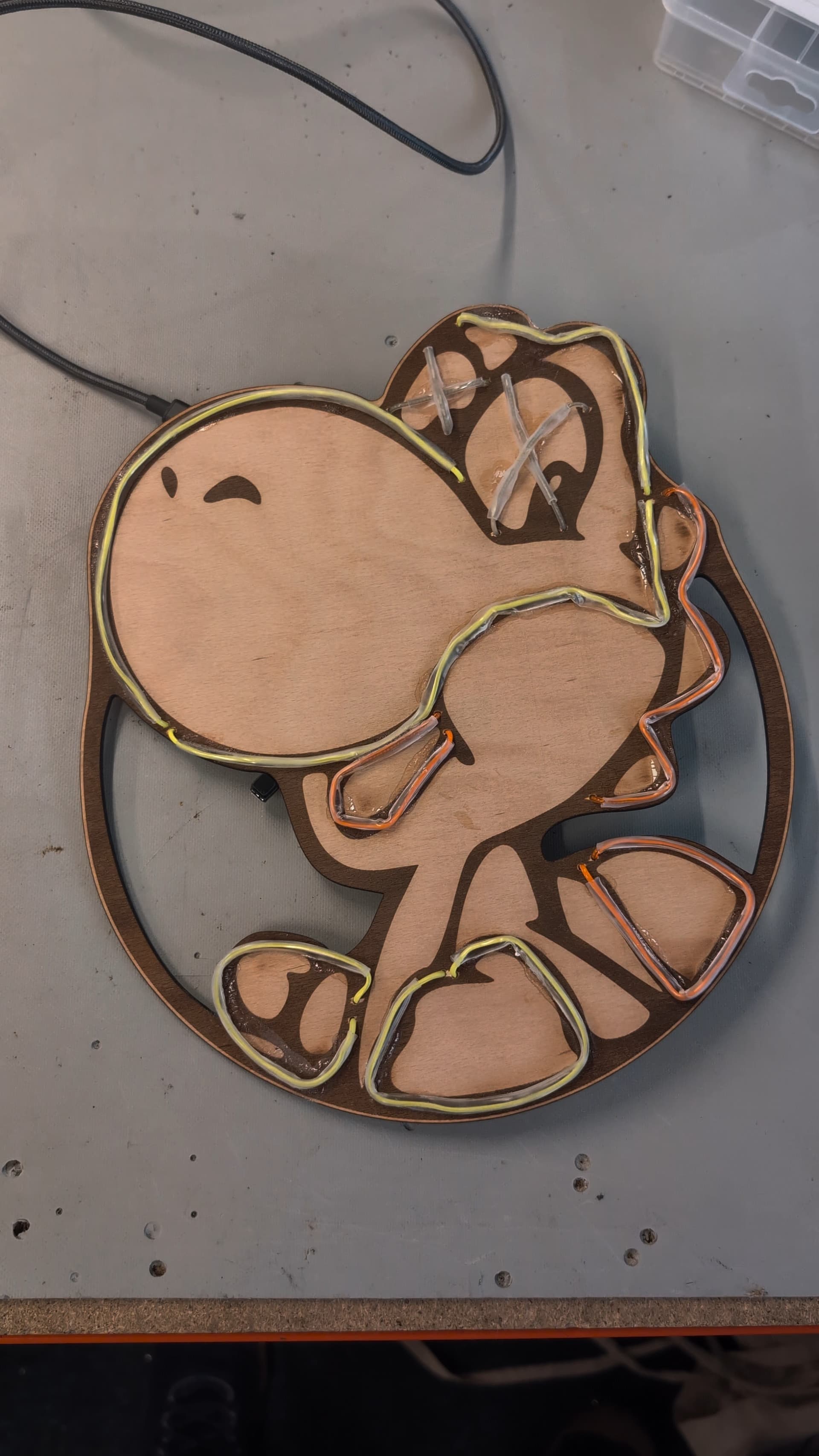

Covered the noodles in clear heat shrink so they could be glued to the wood. I’m sure someone with arts and crafts skills would be able to lay out the noodles better, surprised I don’t see more of this kinda thing.
