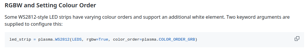

The docs are here: plasma/docs/plasma.md at main · pimoroni/plasma · GitHub
The link above is a direct link to the section that deals with RGBW strips.

I read through the information there but see no example of how to set the W led, only the RGB ones.

The link is to this section:
The section explicitly is about WS2812-RGBW LEDs. And there is even a code example on how to to it.
But in fact they miss an example on how to pass the w part. You can just add it as an additional parameter to set_rgb().
