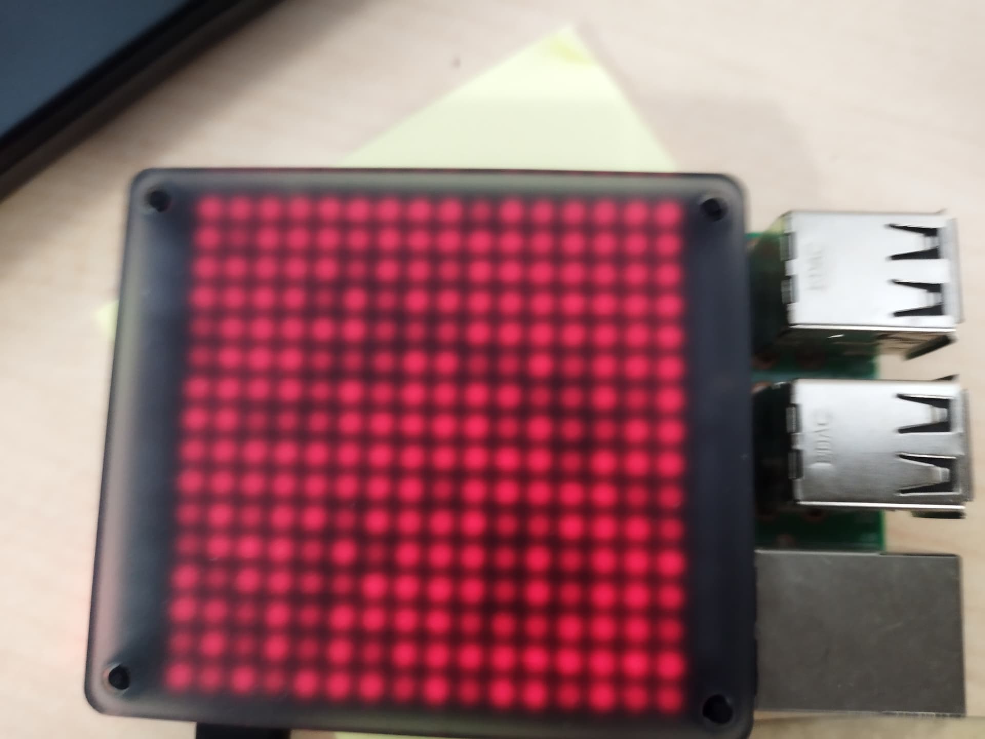

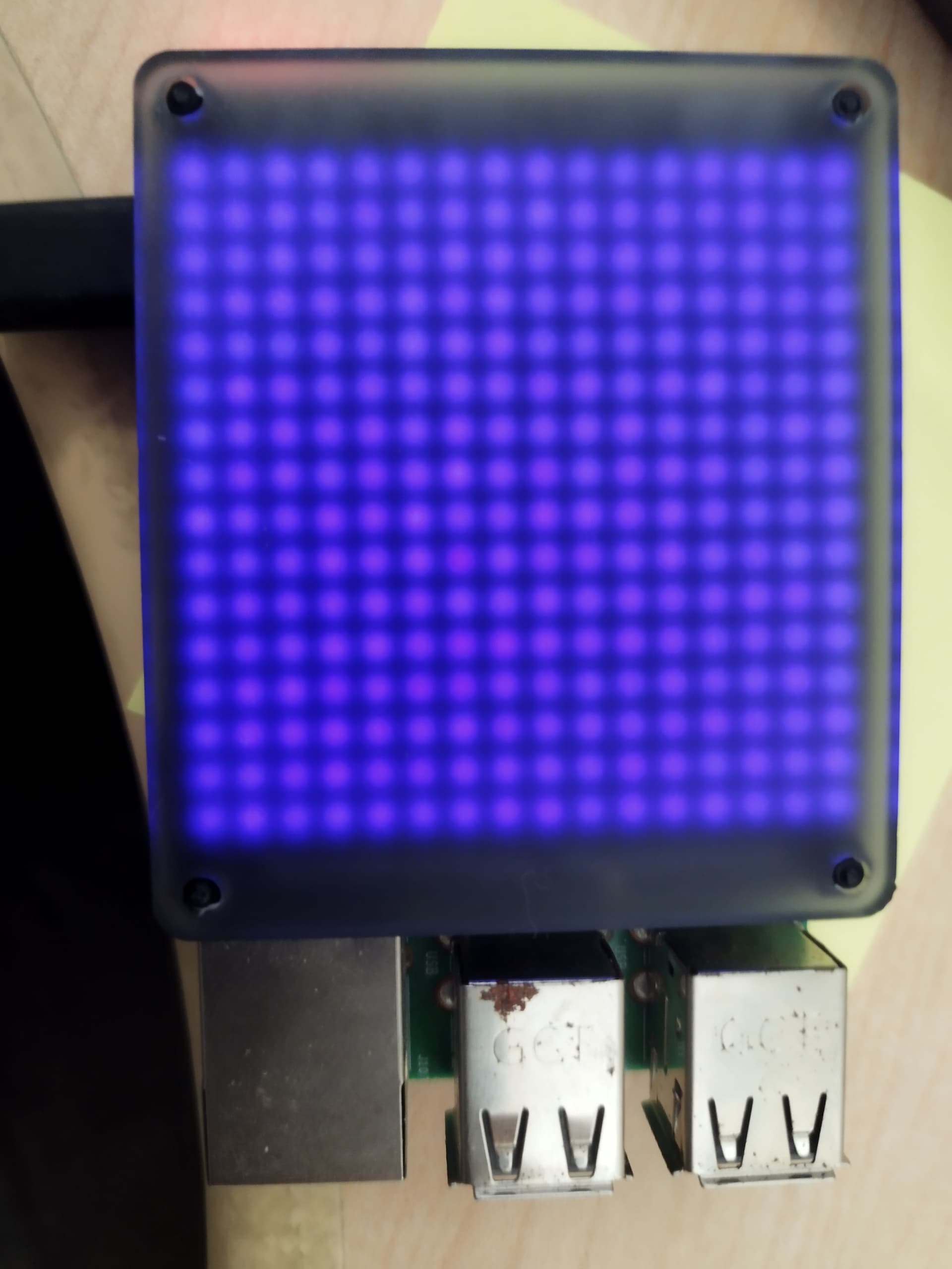

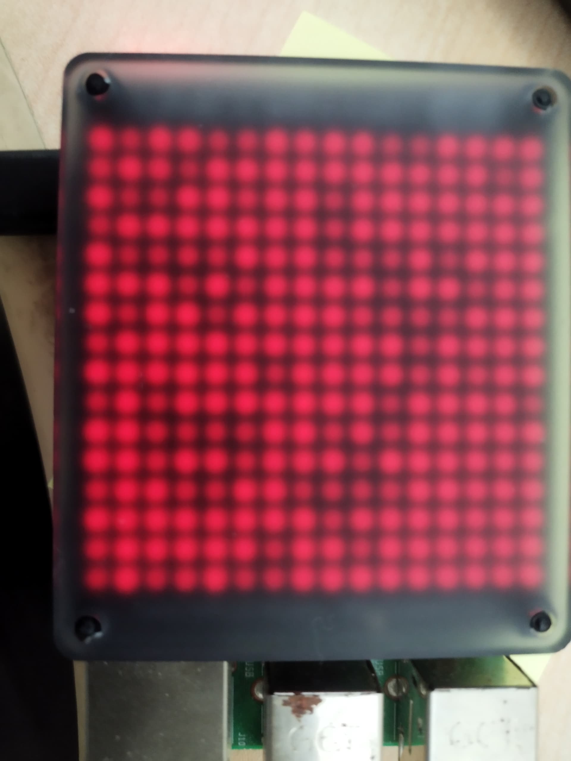

I got a non uniform light coming out of my HAT, only for the red component
In green and blue the LED are uniformly shining.
Do I miss something or is it a possible defect?

After testing another Raspberry Pi I still get a non uniform red output.
This is my test code for the HD. Might be worth running it to see if you get the same weirdness with red?

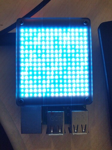

Nope same issue
(was not aware of this set_all() function, but it is relatively the same as my code)
Here is a picture of the white light in your test code, you can see some LED are more blue than other (because of the lack of the red)

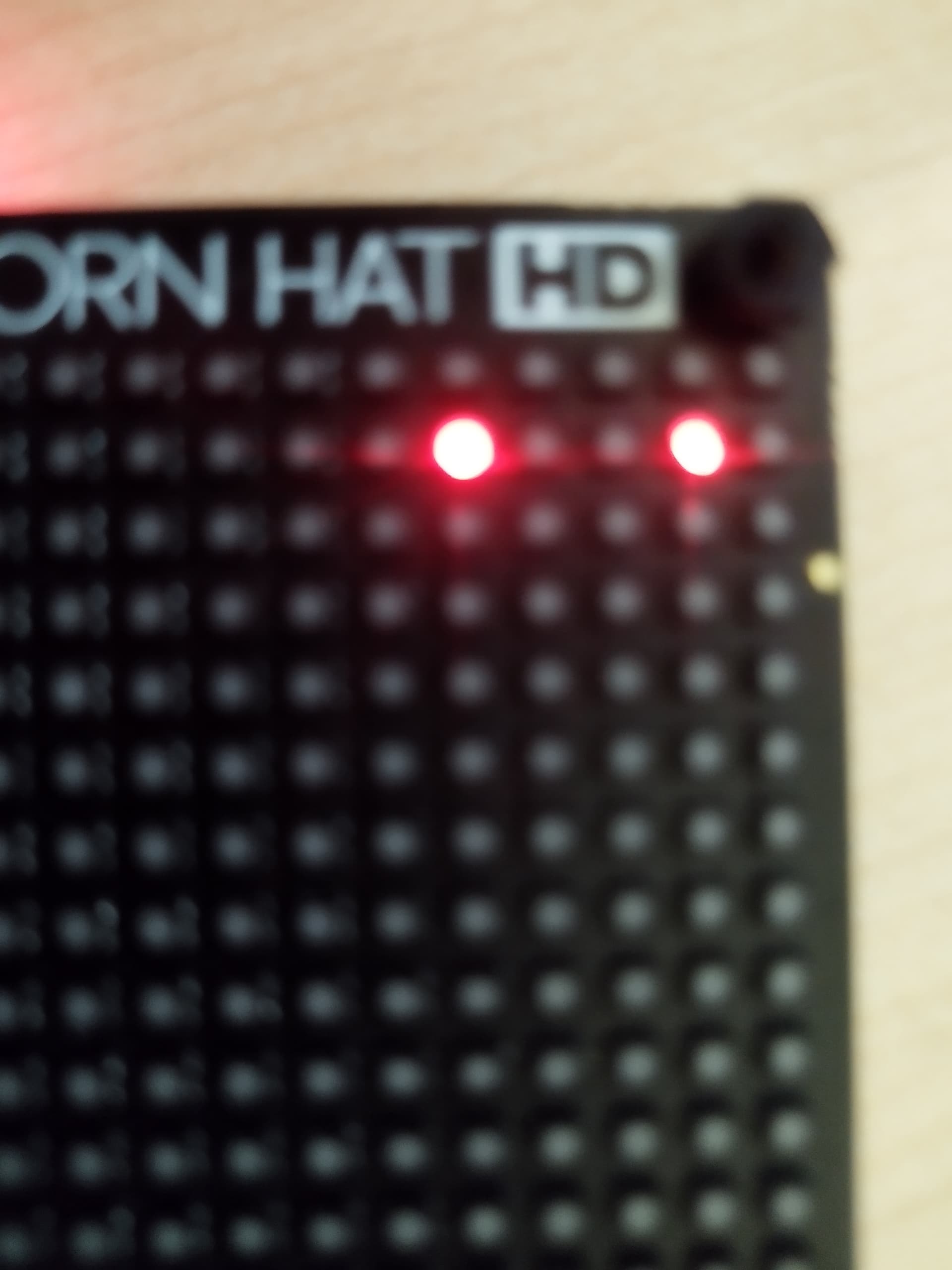

Else here is some picture with only two LED on.
You can see the difference (not easy, but the left LED is Brighter than the right one).
Sorry I didn’t reply sooner. It looks like a hardware issue to me. There is a link on the shop page to contact tech support about it.
