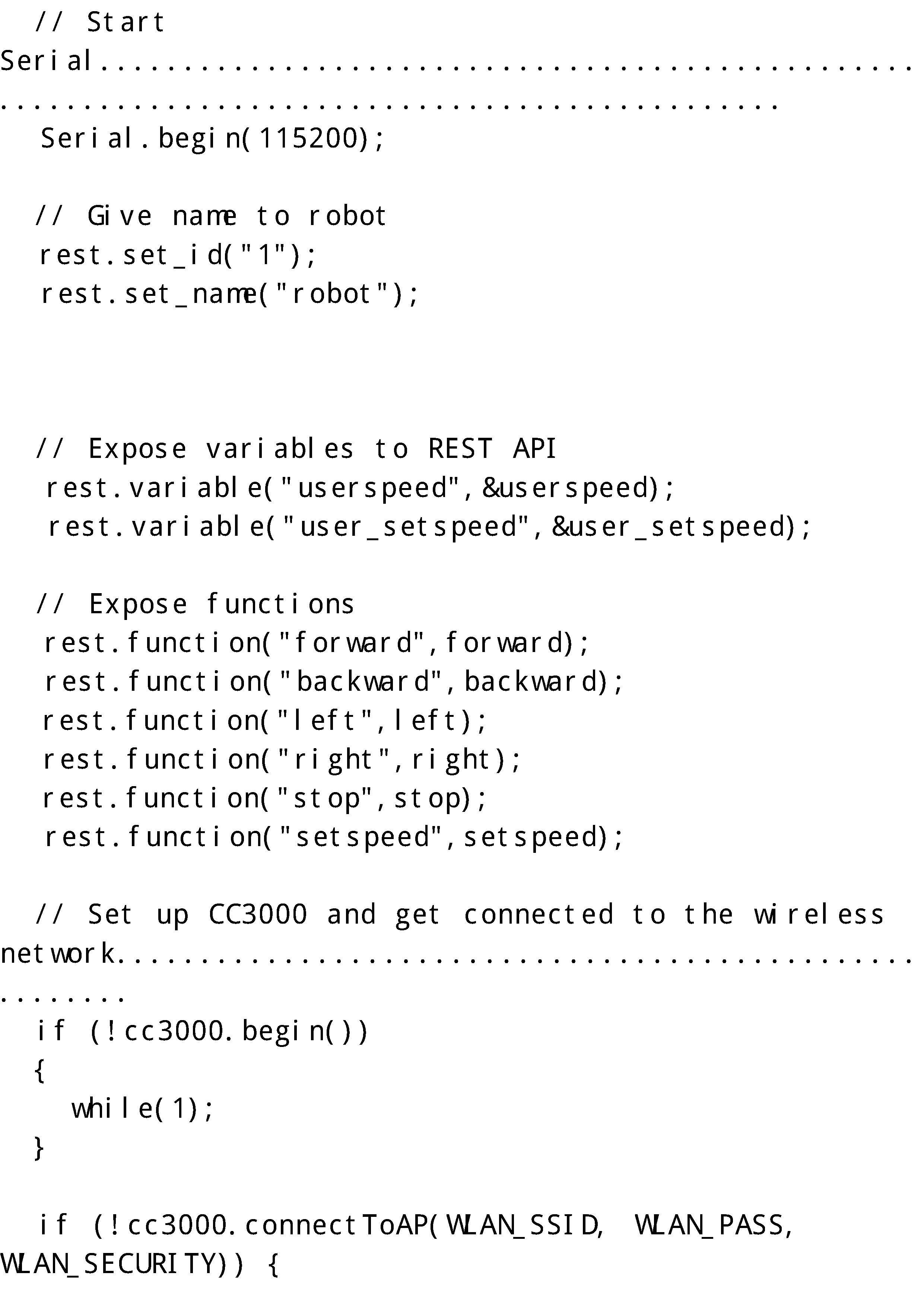

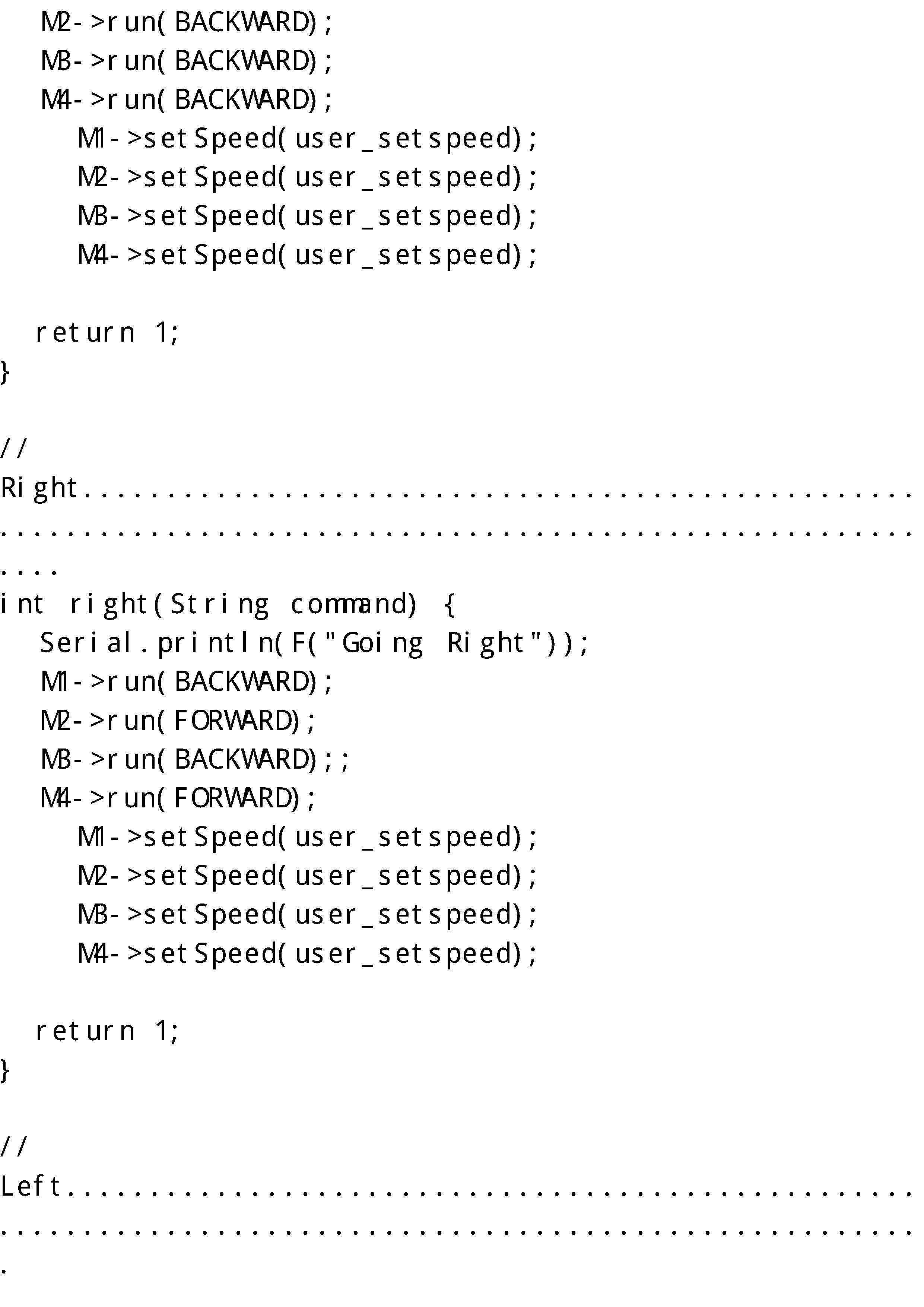

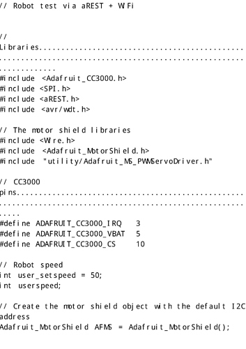

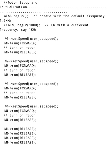

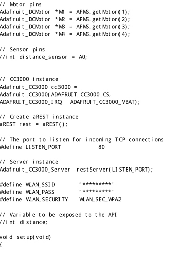

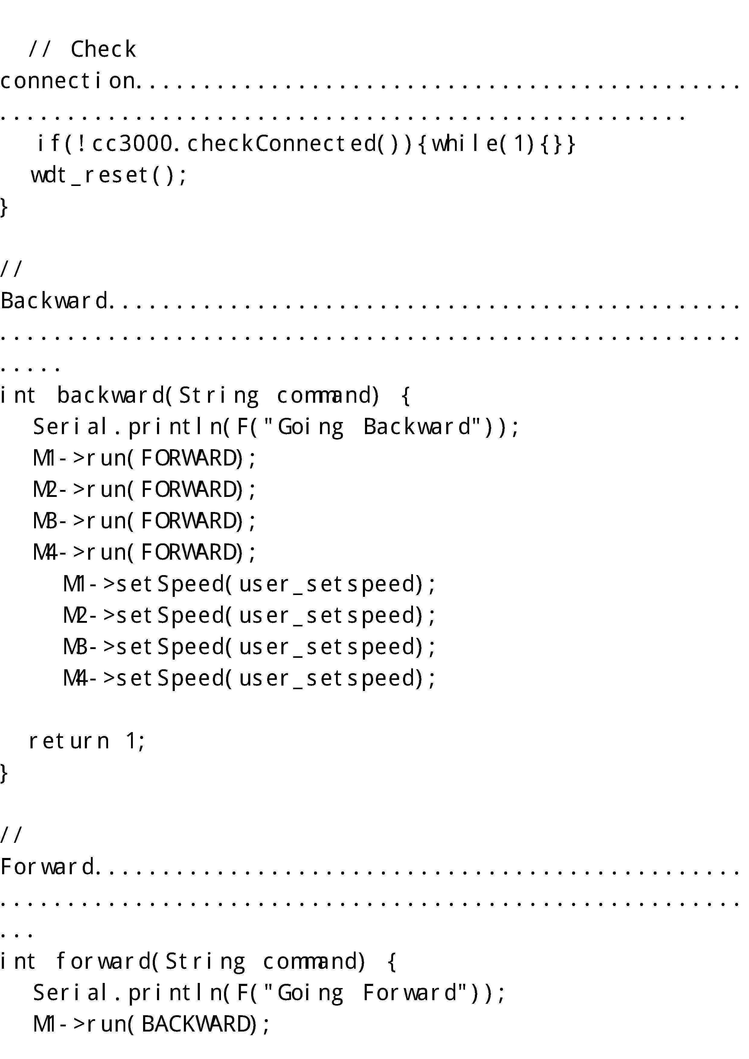

Before developing the robot and GUI further to incorporate sensors, I would like to be to set the speed from the GUI.
This is where I hit the problem.
The Problem
I would like to set an adjustable value from 0 to 255 on the GUI, preferably via a slider control.
The web page currently consists of 3 parts, the HTML based front-end, which uses javascript and jquery to recognise the button clicks and slider values and send them to the PHP script which is used to ‘transmit’ the information via Curl to the Robot (Arduino). The directional functions work well but the slider control level isnt being sent to the Robot. Im pretty sure the Arduino side of things is working as the initial 125 speed value is set to zero when trying to set a new speed level via the GUI, regardless as to what the slider value is. I think the issue lays with the javascript and or the PHP, however I know next to nothing about either and marginally more than that about HTML.
Images of the code are attached
