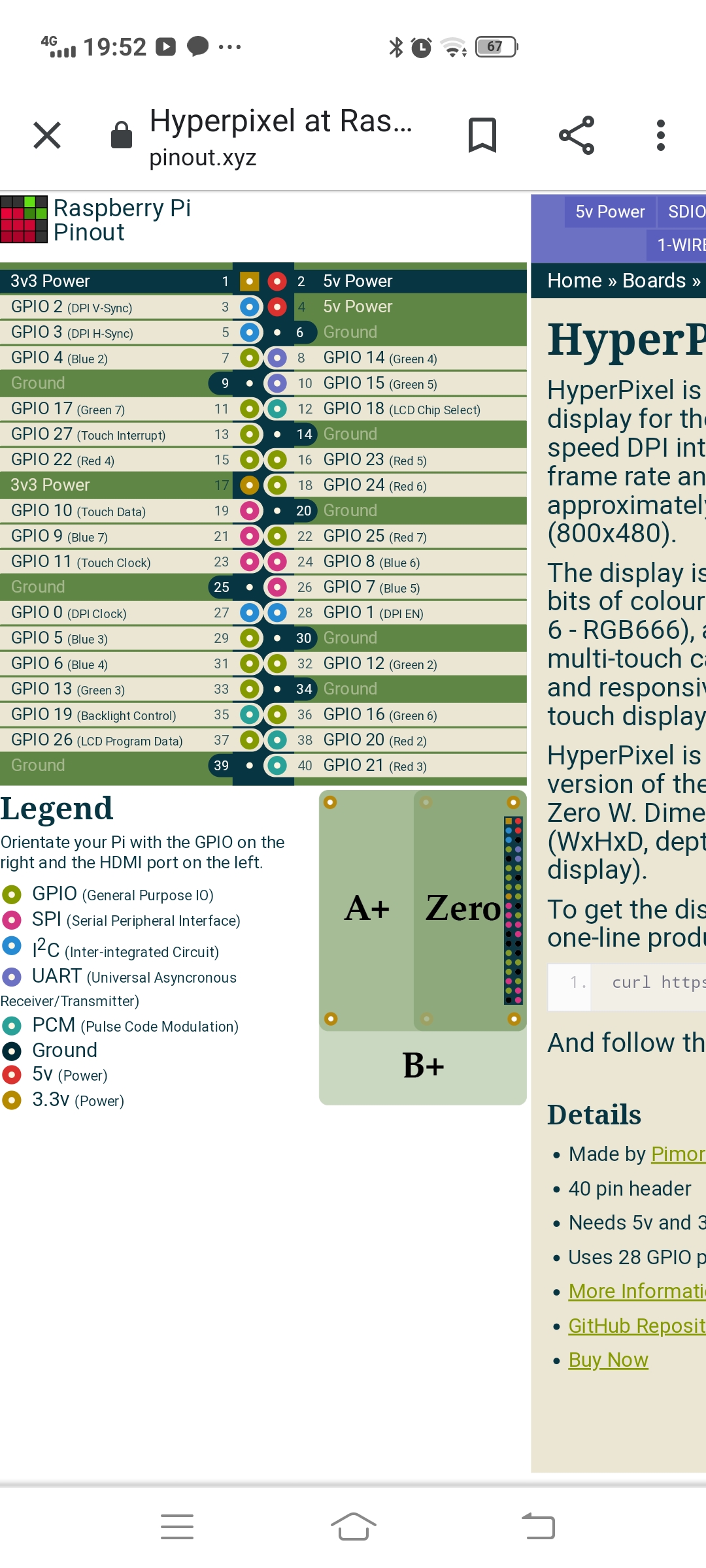

hyperpixel (green 5) connect to raspberry pi(gpio 15).
i will switch hyperpixel(green 5) to other raspberry pi pin.

What other pin are you going to switch it too? I ask because there are no free pins, they are all used for something?
Plus, how are you physically going to rewire the connection electrically?

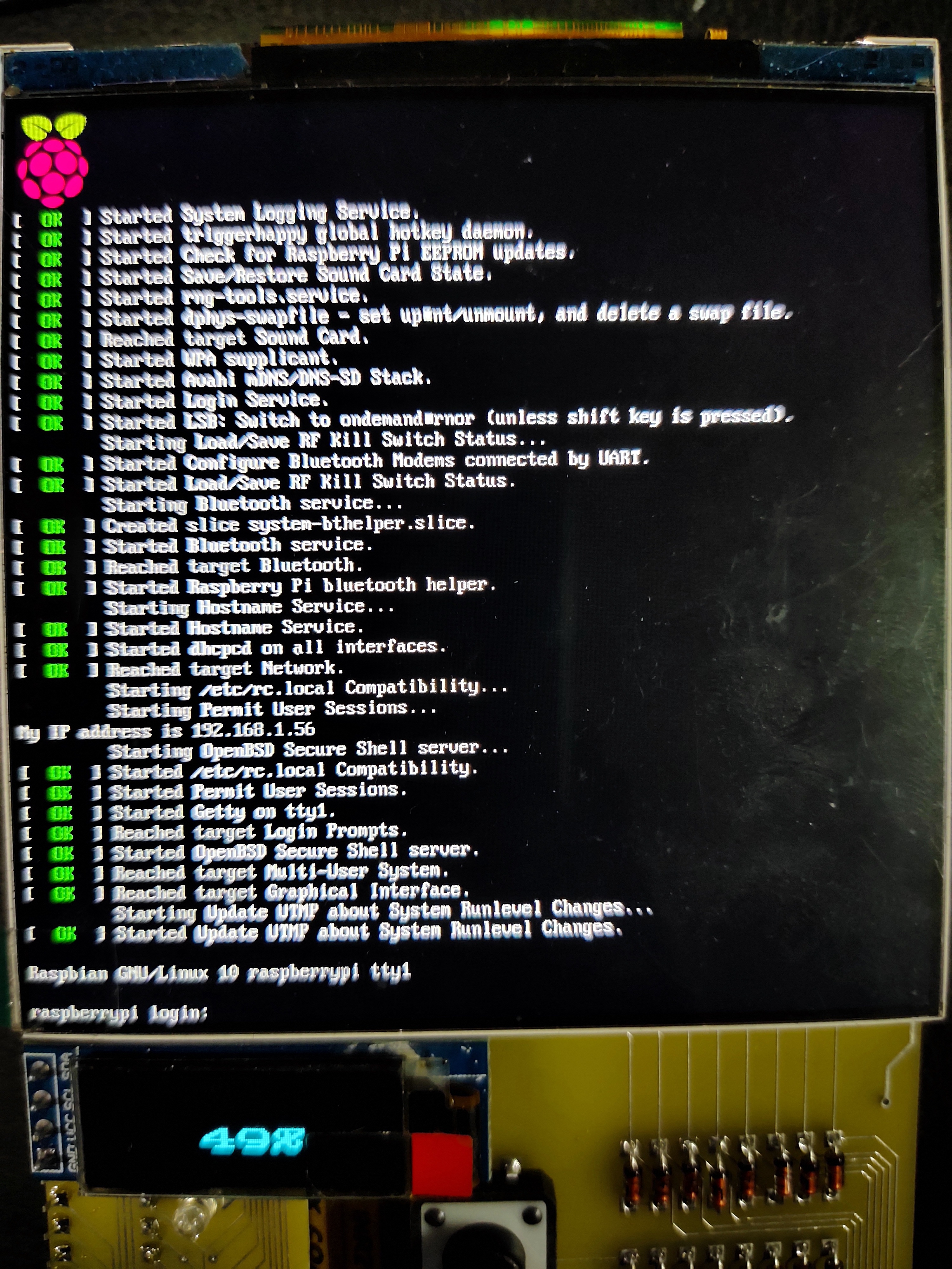

i wiring on own design PCB

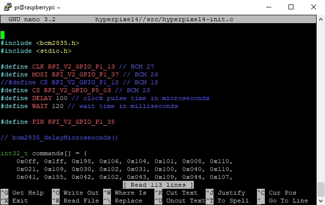

now i edit “https://github.com/pimoroni/hyperpixel4/blob/square/src/hyperpixel4-init.c”
for change hyperpixel (CS) form rpi gpio-18 to rpi gpio-28 but physically wiring hyperpixel (CS) connect to GND
i test run it work fine
now rpi gpio-18 is free.
i want define rpi (gpio-18) for hyperpixel(green 5).

I solve this problem.
Thanks for your help.
