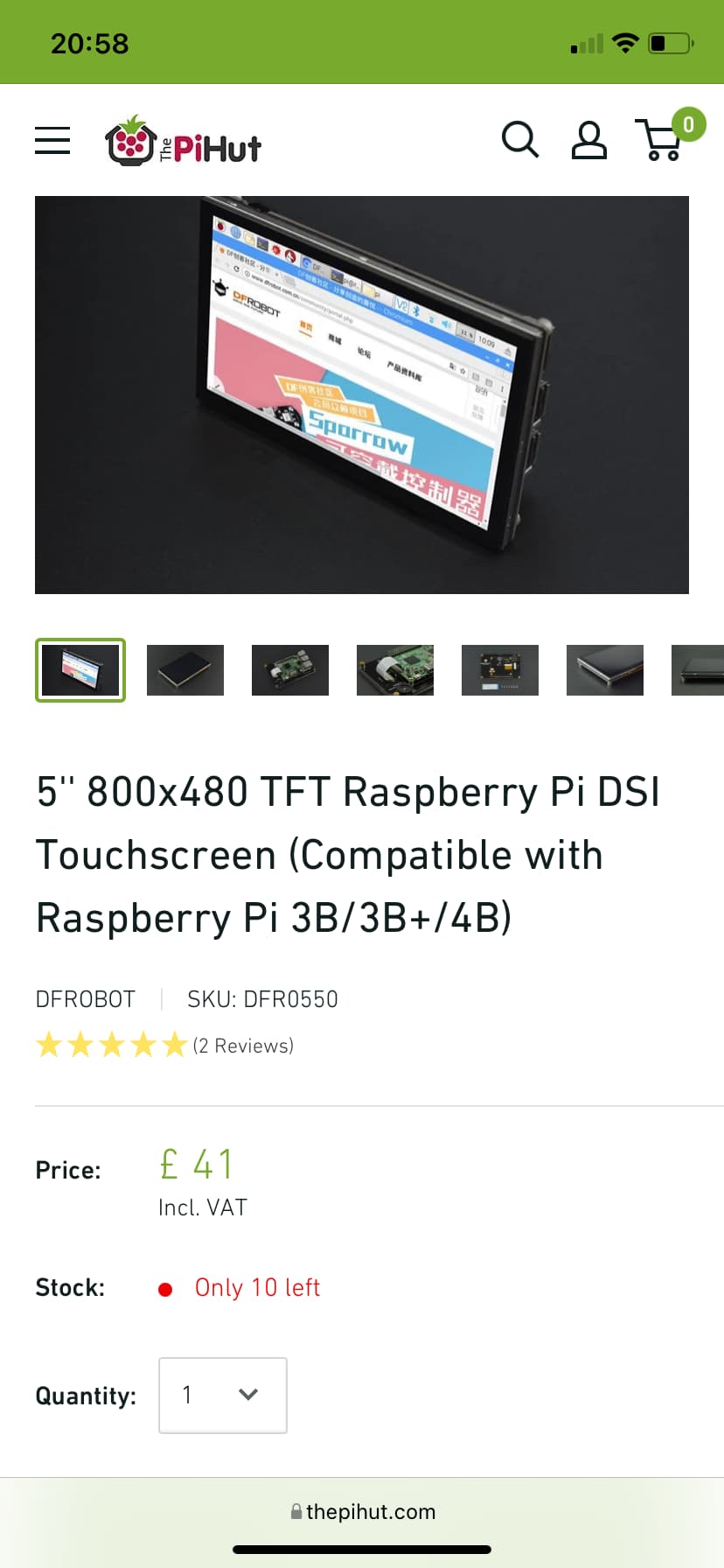

Evening all,
I have just attached the above display to a Pi 4 and all works well except an onboard touch screen keyboard. Has anyone worked with one of these?
Thanks in advance.
Chris.
Going to need a link to the one you have, to help. ;)
So does the touch work at all? Asking as I’m not 100% sure what the issue is. I have the official 7 inch screen that works via DSI. Touch works out of the box but you have to manually install an onscreen touch keyboard.
sudo apt install matchbox-keyboard
Is one way to do it.
Hi yes the touch screen works fine, and I have downloaded Matchbox but it occupies half the screen is clunky and hopeless.
Instructions show it looking completely different to how it displays on my touch screen. :-(
