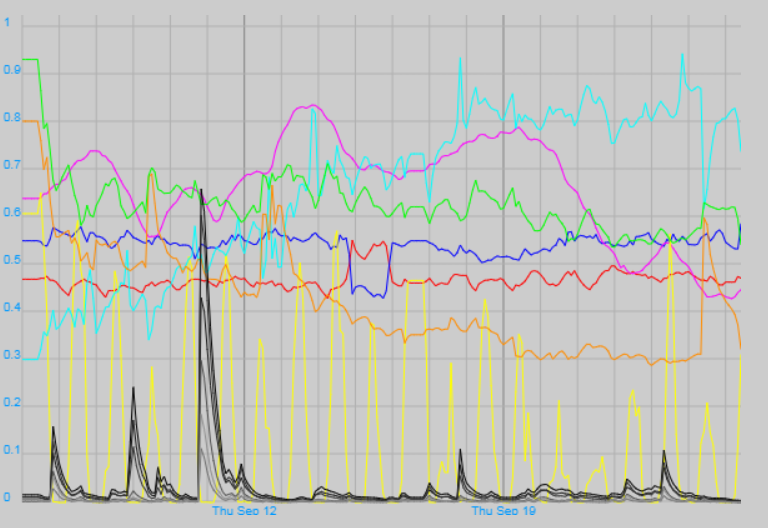

This is what I am seeing at the moment indoors in my lab:
It looks very similar to your readings but it will go to much higher readings of all sizes if I do a stir fry in the kitchen or change the bedding in the bedroom. It is just very low this morning.
