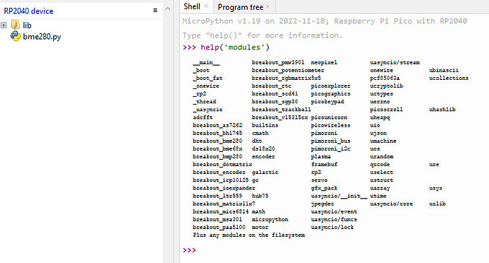

Entering the command below in Thonny will show you the built in modules (though not any you’ve installed yourself, I think)
help('modules')
Thanks I will try this evening.
I’ve not yet installed any additional modules, and I even don’t know how to do this at this point :D
