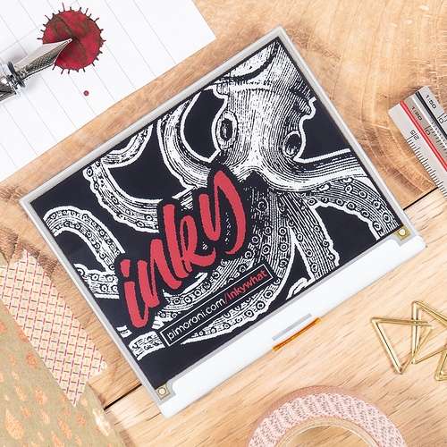

Unrelated, but what is an “Inky wHAT”? Is it a typo for the Inky pHAT? My forum name (without the “72”) has been my IRL nickname for the last 40+ years.
It’s the bigger Inky “wide-HAT” version of the inky pHAT.
