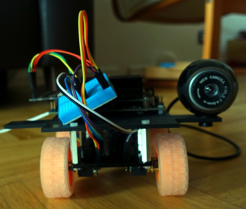

So the problem is that you don’t have as flexible PWM. Also the available current seems to be lower.
But one can get softpwm to run and then the explorer phat motors work for me:
