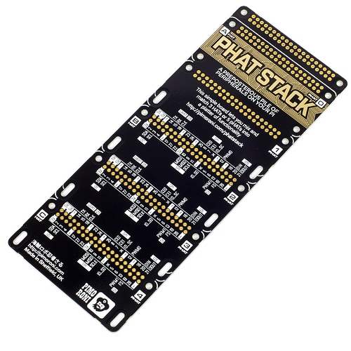

If you were to try to do it with the one Pi I would go with the phat Stack
That’s assuming there are no pin conflicts between the keybow and Pirate Audio pHat.

If you solder a female header on to the bottom side of a Pi Zero, same way you solder a header on a pHat, you can plug it in to the pHat Stack and not have to use the ribbon cable. Everything will work just like it was plugged in via the ribbon cable. You can’t ever plug a Hat in on top of the Pi the standard way. It’s basically dedicated to the pHat Stack.
I’ve done it on my mini black hacker boards, which are a smaller version of the pHat Stack. I used a 90 degree header so my Pi points up, It makes it easier to pug in the cables, but a normal female will work too. Just plug the Pi in at the end.

Just looking at mounting these (mini Keybow of course) on HAT hacker together and looks like CS on GPIO 24 would conflict when trying to access SPI.
