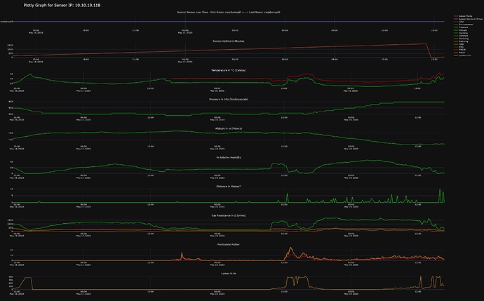

The base install includes an sql server, plotly, and options to upload to weather underground, opensensors and luftdaften. Although I’ve tried to register with luftdaten many times, they’ve never sent me any confirmation emails. Maybe they don’t want any Canadian sensors…
