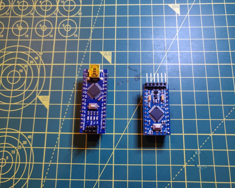

Chip Choices
Arduino Mini or Arduino Nano ?
Yes these are clones, as the end product is going to live permanently in a robot shell with no future access.
They will live there forever and will never be reused.

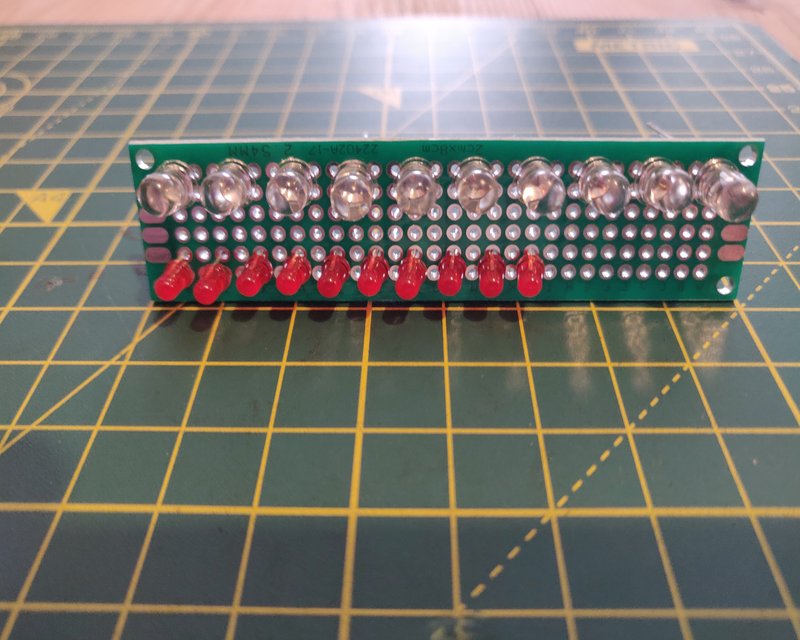

The original plan was to have larger LEDs.
These 10mm clear LEDs are crazy bright but the overall form factor could be too wide.
LED Comparison
The 10mm LEDs would have a greater impact and are brighter overall but would take up too much horizontal space.

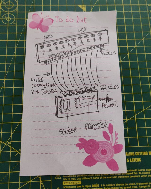

A Slight Redesign

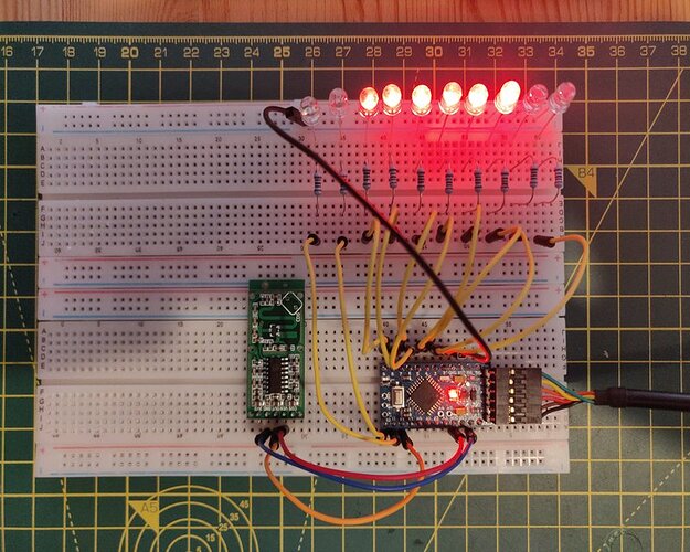

So at this point it was decided to add in motion detection functionality.
The plan being that when movement is detected it will trigger the scanner effect.
Time to add a PIR sensor into the mix.

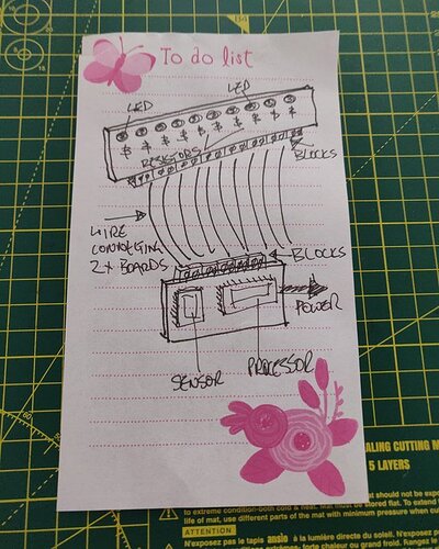

I have zero CAD skills but I do own a pen.
A Working PIR
Using a pair of breadboards I can now trigger the scanner effect.
This particular PIR detector is (I think) the HC-SR505 with an effective range of 3m.

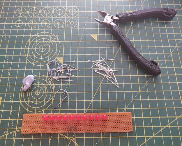

LEDs in Place
Now that the proof of concept is all working, time to dig out the toolbox.

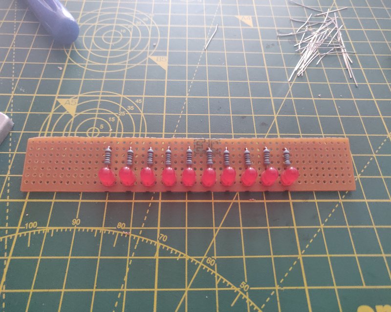

LEDs on Veroboard first.
LEDs and Resistors in Place
Closely followed by adding all the resistors.
(The underneath of the board has already had the appropriate tracks cut.)

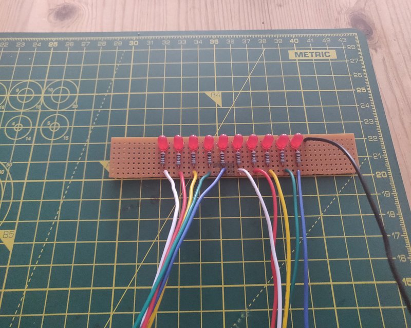

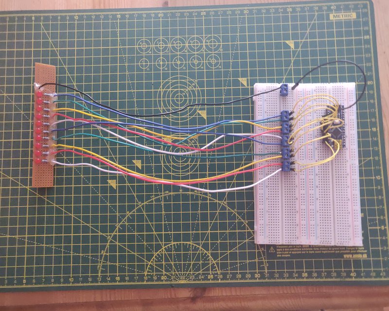

All Wired Up
And then start to create a wiring loom.
Testing The Arduino
The LED board has been wired up (and liberal amounts of hot glue to ensure that none of the wires break free.
Testing to see that all of the LEDs still work.

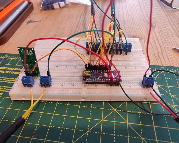

Testing The Arduino and PIR
With a working LED board and a known working Arduino it’s time to add in the PIR module.
There are two sets of buttons now:
  • A power button that when on, the scanner effect will run
  • A sensor button that then on will only trigger the scanner effect when activated (asssuming the power is on
Final Board and All Wrapped Up
Finally all working and wrapped up in cable tidy wrap.

Nice, that looks pretty darn cool. =)
Hi Kerry,
Ta, I don’t do a lot of Veroboard work these days so it was nice and quite satisfying to go back to it.
Cheers,
Simon.
Nothin wrong with old school. I use a lot of Proto Hats and proto boards in my projects.
Did some poking around and see that the Blinkt and LED Shim both have Larson example code for Python. Might give that a try with my just sitting there doing nothing Blinkt. I have two LED shims but they are in use.
The first thing that came to mind when I read your first post was,
By Your Command lol. showing my age, =)
