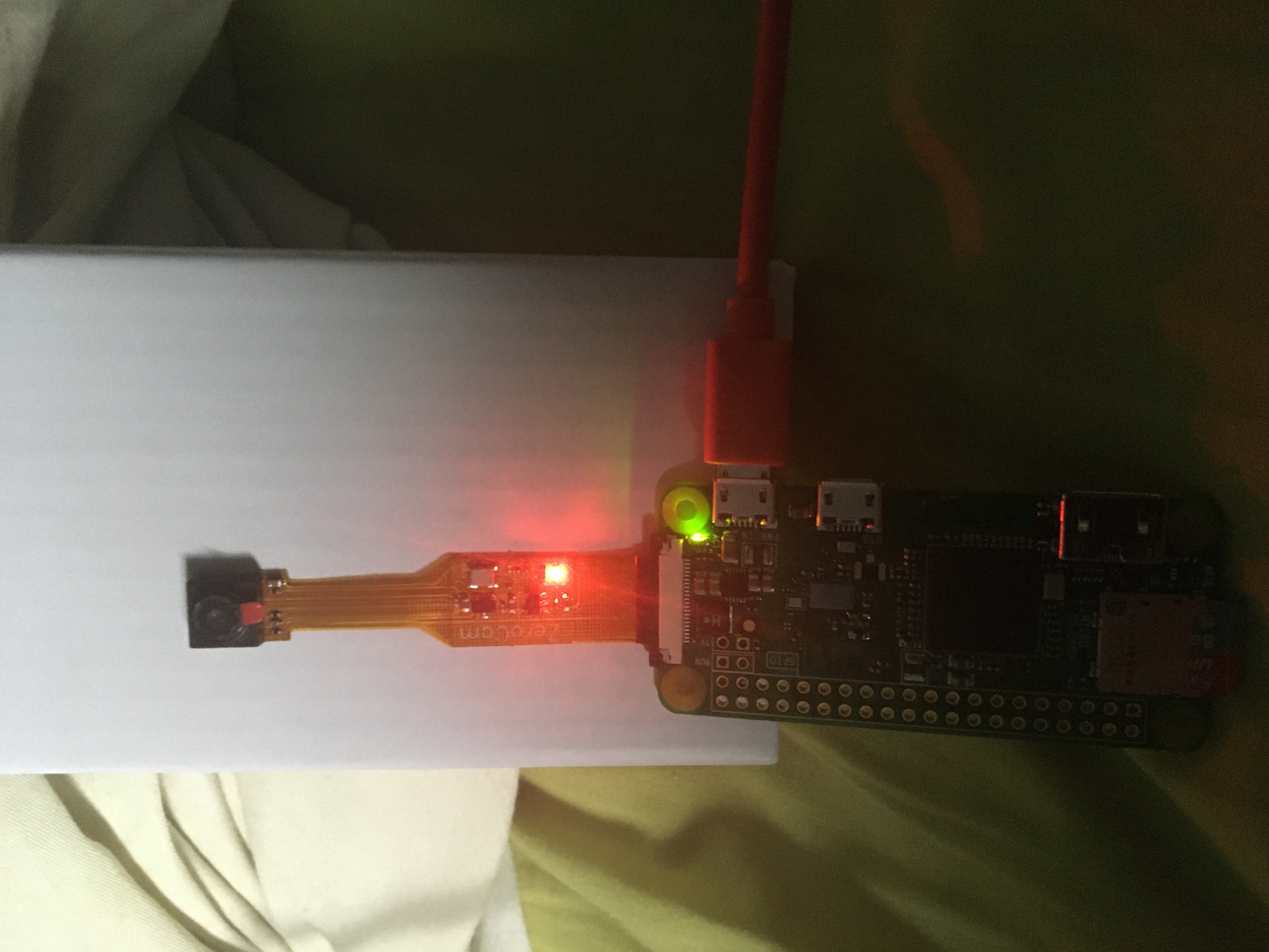

I think you might have the big end of the night vision camera cable plugged into the camera upside down - try unclipping the connector and flipping the cable over so that the metal contacts on the cable face towards the camera board!
H
I agree, I think the camera needs to be turned 180 and reconnected.
