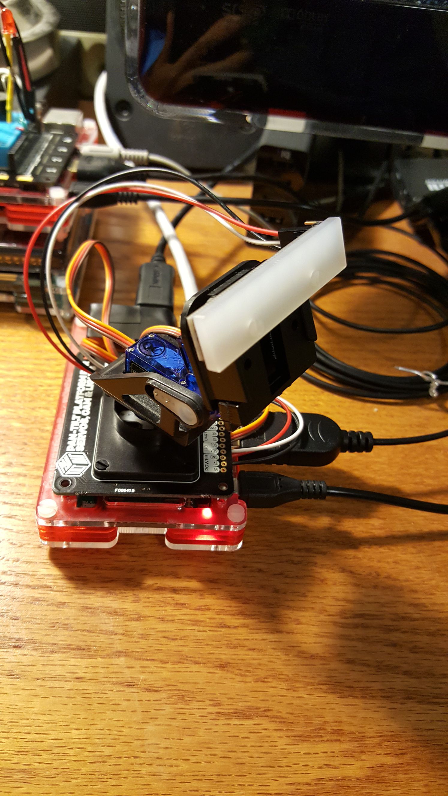

Just received two Pan Tilt Hats from Adafruit last weekend. The servo control works well with the example python scripts, except the adafruit neopixel strip is not working as in the neopixels.py or grbw.py. Tried both Pan Tilt hats with same results. This neopixel strip is checked with Arduino and works fine. I tried both Pi2 B+ / Wheezy and Pi3/Jessy fresh install. Same issues for all the possible combinations (hardware/software). I could not figure out why. Anyone experience the same issue with neopixel strip/PanTilt hat combination?

How are you hooking the NeoPixel strip up to PanTilt HAT?

The neopixel connection is shown in the pictures attached. Red +5V/White Din/ Black GND. That works with Arduino.
I could not uninstall pantilthat with following error message “Not uninstalling pantilthat at /usr/lib/python2.7/dist-packages, owned by OS”.
Pimoroni dashboard did not have uninstall function either.
Please refer attached pictures:

I also tried another neopixel stick (photo) which is essentially the same one and also same result. I am not sure if the NeoPixel “C” in the label means anything related to this issue.
Pretty sure these are run of the mill RGB NeoPixels, and should be the same ones I tested the firmware with. Colour me confounded! No doubt we’ll have some lying around to test and try to re-create. Unfortunately I’m presently away from the workshop and don’t have any to hand right now!
