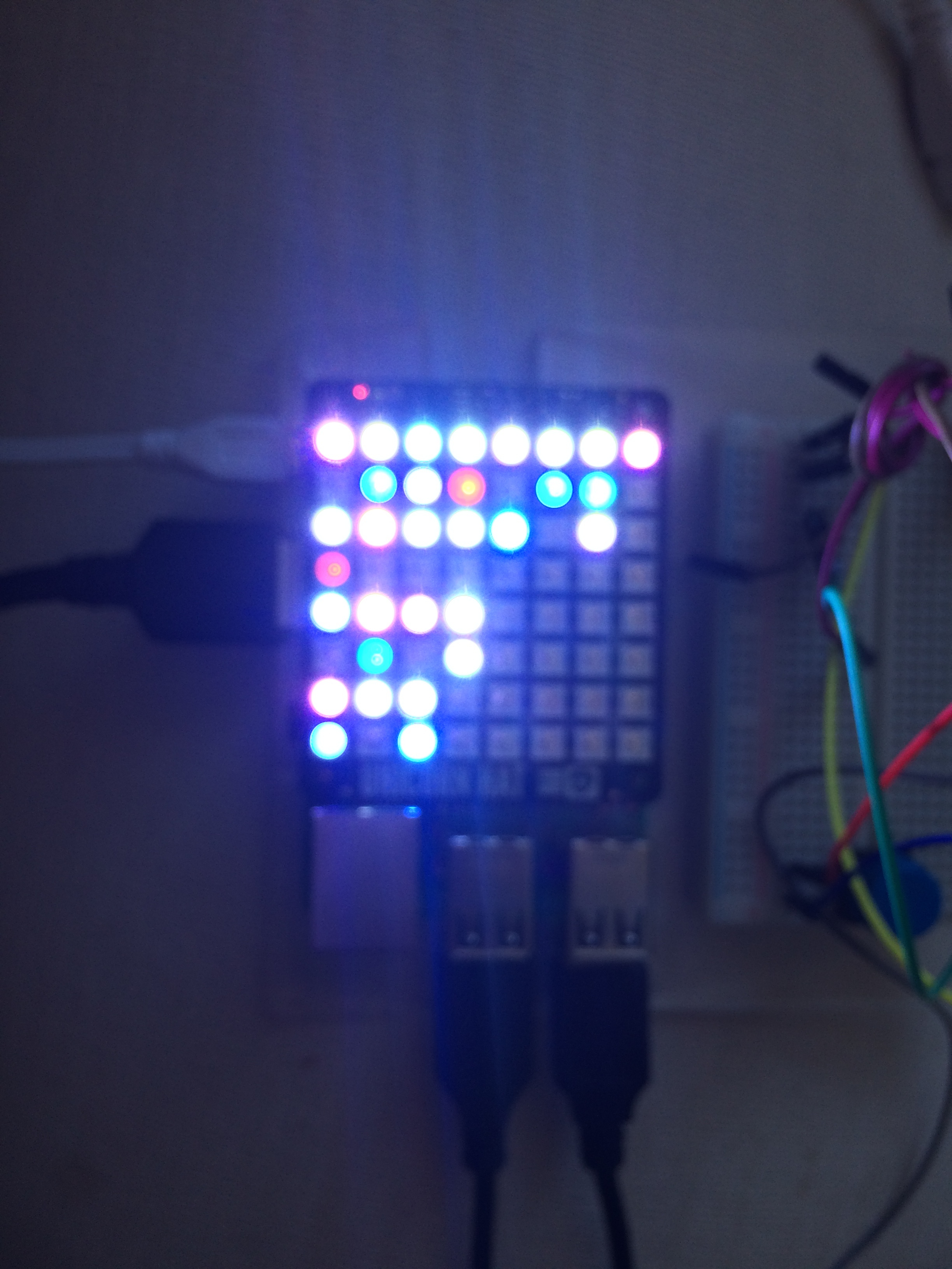

Installed on a fresh SD card, but now the HAT just displays “noise” (random LED’s on), and isnt affected/doesn’t change when I run the scripts
Like this:
This may be because audio is still running- which conflicts with the functionality of Unicorn HAT (both analogue audio and Unicorn HAT try to use the onboard PWM hardware to produce their signals). Make sure: dtparam=audio=on
is commented out in /boot/config.txt
, ie: any occurrence of this line should have a #
before it.
