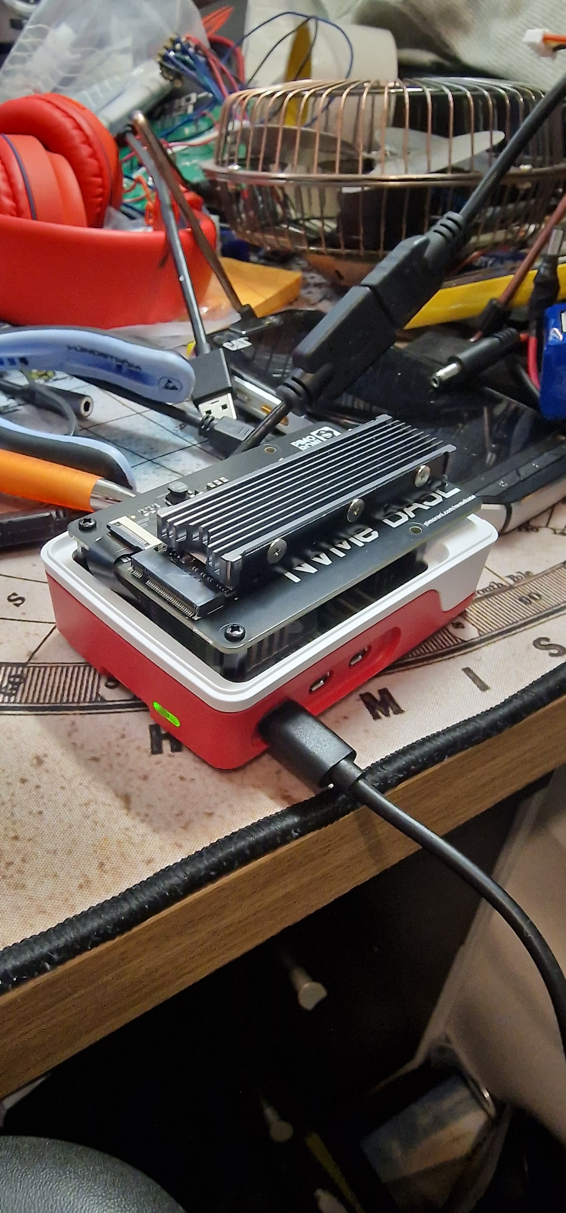

Had to take a day off of the pi. A bit of background, which youll see in the pic. I have nvme drives running on a raspberry pi 4 (usb3), and an orange pi 5 (nvme extension cable). Both work perfectly, though the orange gave me about 30min worth of trouble at first.
This raspberry pi 5 and the nvme base has been many, many hours, and still only once seeing it pop up on the screen as recognizing the drive is there.
I did try running pig tails from the base board to the 5v gpio, just to rule out power. So now we are down to 3 options. A bad pcie cable between boards. A bad nvme base. A bad raspberry pi 5.
If we just had a dang nvme socket on the bottom of the raspberry pi… The orange pi almost has it right, but the placement and orientation of the socket is aweful.
Anyhow, im going to test the first two possibilities when i get the new base board. The rpi5, while im hesitant to believe it, has an equal chance of being the problem, but thats only a 3rd or the possibilities.

Received the replacement today. My problem is sorted now, thank you for all the help provided.
My setup looks like this now
