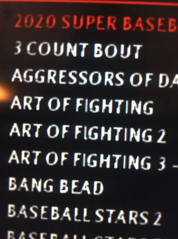

Could you provide a photo, please?
The first image shows strange circles bars.

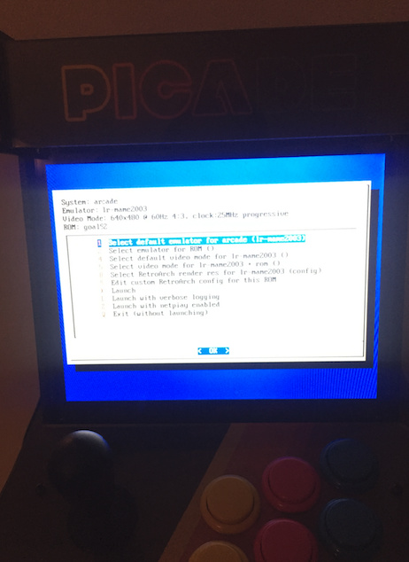

The second image shows the problem about fonts

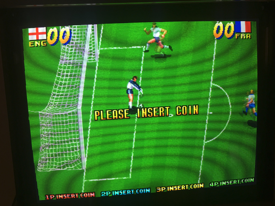

The Third the evident problem of resolution.
This 3 problems not appears in separately alimentation.

Looks like your Pi isn’t providing the native resolution of the display.
You could try to add:
hdmi_group=2
hdmi_mode=16
to your config.txt file, that will force the native resolution of 1024x768 @ 60Hz

I’ve solved with Kai solution.
Now working fine!
