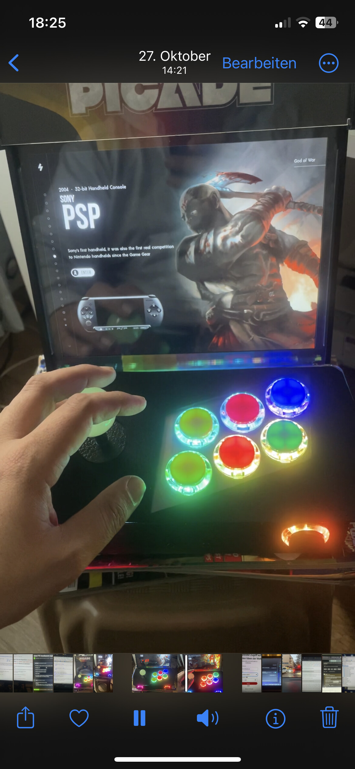

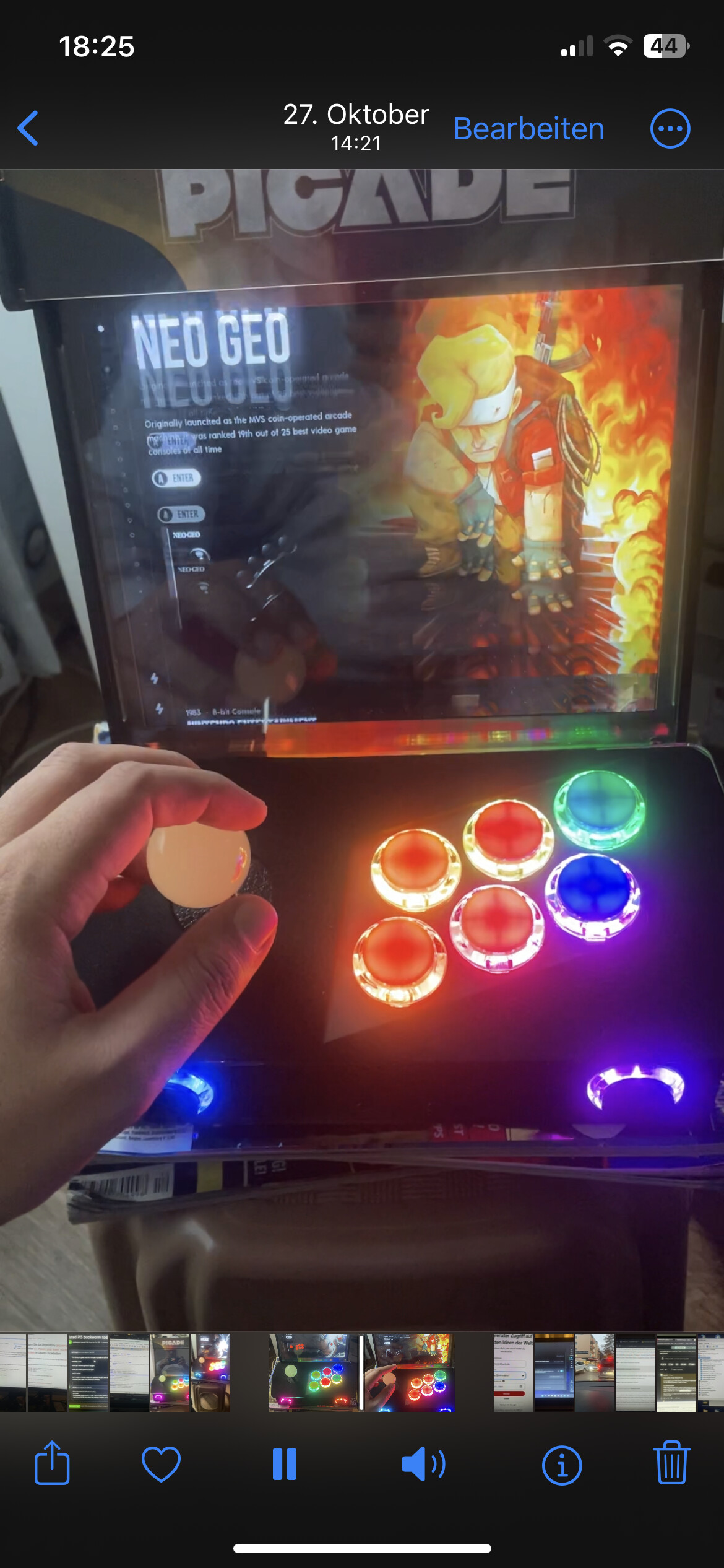

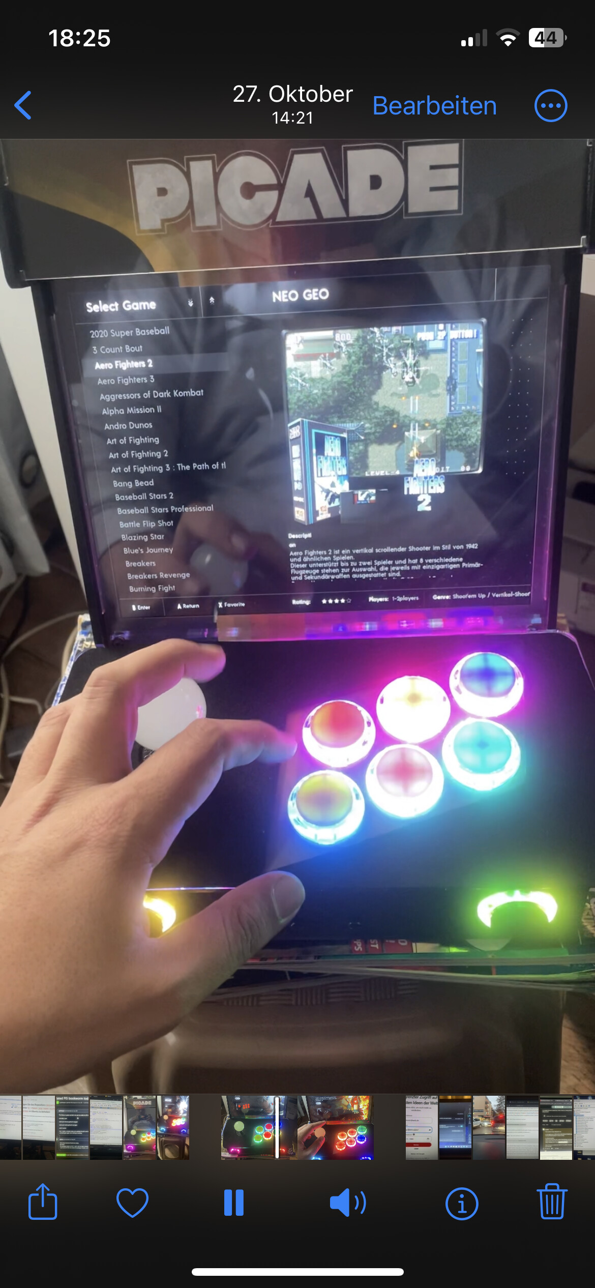

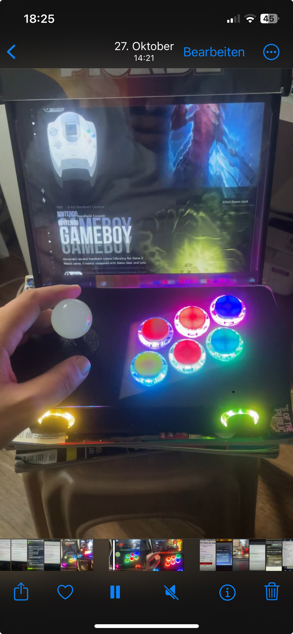

Thanks a lot for your support, I will try that
Hi Pilou it doesn’t work, but I tried many things before with pip and python3 installs so maybe it’s messed up so far that your line didn’t help.
At one time I tried it with a pi 4 and buster os just to see if the lights work. So after testing It won’t will work even with a pi 4 and buster.
Then I wanted to install it back on my picade with pi 5, so I stick all connections back to my picade x hat and it worked !!!
I was very surprised so I turn the picade off install the connections again ( this time nicely) before I just route it outside the picade to the pi 4.
And guess what ? Nothing no lights anymore . I don’t understand it and gave up.
Was all the wiring wrong and the one time I put it from the pi 4 to the pi 5 I did it right?
I checked before the wiring 10 times the only guess I have while I put it back and it worked maybe I did a mistake and connect it somewhere else but in my his wrong way it worked ?
