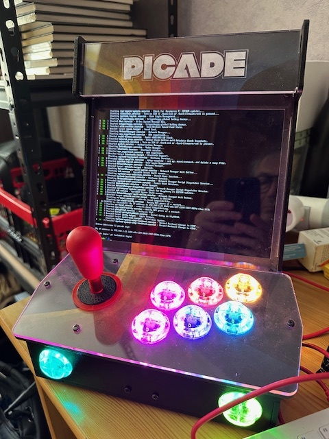

I have a Picade 10" from which i have changed the “old” PI4 by a brand new PI5 with a 512K NVME installed on it. It works just great! It’s a home made solution mainly based on the SonicProd solution and with ArcadeFlow as the Front-End running on Attract Mode +. And it’s just a killing front-End to execute MAME games with a PI5.
i also have the Plasma buttons Kit installed on my Picade. They worked just fine with the PI4 but not with the PI5! I abandonned few months ago to try to make them work. It seems that there was a Python GPIO library required for the Plasma buttons which didn’t exist for the PI5 but I’m not an expert in those deepest technical things. I thought that after several months this problem would be solved now. But it I still didn’t find the way to make them work. I see that the buttons are still available in the Piromoni shop with no restriction concerning the PI version. So my question is: how do you make those damned plasma buttons working on a Picade with a PI5?

Your solution worked just fine, many thanks @alphanumeric ! :)
git clone -b master https://github.com/pimoroni/plasma-python.git
cd plasma-python/
sudo ./install.sh
Nice, I was hoping one of us would stumble on the answer. =)
