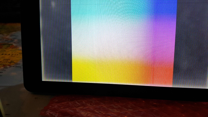

I have a new Pimoroni 7" Touchscreen connected to a Raspberry Pi 3 Model B V1.2.
I know the Pi3 works - it has been tested and updated using HDMI and a separate monitor. However, when I plug it into the independently powered 7" touchscreen all I get is a flashing, fading test pattern. See the attached pictures. Any suggestions?

I’m only allowed one image. However, the test pattern flashes and fades in and out when seen live.
Here is another picture:
And one more:
This suggests that there’s no video signal reaching the display. Are you sure that the ribbon cable is the right way round? Try flipping it the other way round, i.e. so that the copper contacts are inserted into the connector the other way round. Let us know if that works…

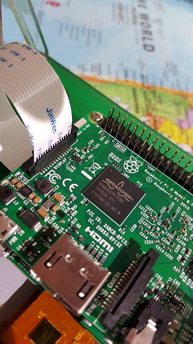

Could you take a couple of photos of the ribbon cables connected to both the driver board and the Pi, just so that we can sure they’re properly seated in the connectors, please?
Here they are:
They look fine. What power supply are you using?
Two standard UK(220V) plug to Micro-USB connectors. I have the Y connector Pimoroni sold me - and I think it works properly - but I stopped using it while troubleshooting. The RPi and the Screen are powered separately.
Any other suggestions? I suspect the unit is broken and its time to send it back.
